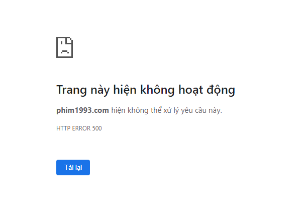

HTTP ERROR 500
I realized that my database is automatically deleted. i try to create new database but can’t create it
please check help me. thank you
I see this error:
DNS_PROBE_FINISHED_NXDOMAIN

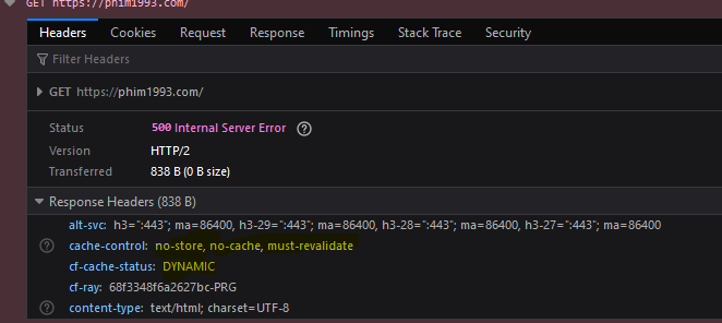

don’t touch anything on CF.
everything is fine but probably your site uses DB but currently due to problems it can’t connect so it throws out error 500
but other files are neatly served like https://phim1993.com/images/icon.png

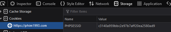

PHP neatly assigned a session
CF cache settings are fine
