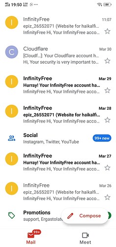

what has happened with the infinityfree service for a while, my site has been hit by the impact 9 times my site has been suspended due to the reason that the i / o limit was reached. I deleted all the website scripts I installed but they are still suspended for reasons of I / O limit. did I do the wrong configuration or how this confuses me and can’t continue my work.
Wait for 24 hours to unsuspend pls ty
Already, even this is the 9th time my website has been suspended, I don’t even do anything, it’s still suspended ![]()
