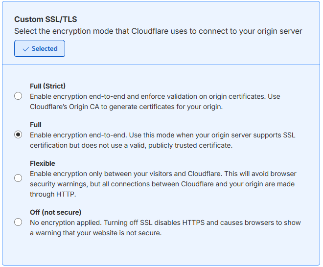

This can be shortened to “Click on the ‘Full’ setting” nowadays, eh?
Unlikely, if you do not specify clearly, user will likely pick the first choice.
“use Cloudflare’s Origin CA,” which doesn’t work on here because vpanel only checks for Common Name, not Subject Alt Name for (i bet) weird reasons :sad_but_relieved_face:
If a subjectAltName extension of type dNSName is present, that MUST
   be used as the identity. Otherwise, the (most specific) Common Name
   field in the Subject field of the certificate MUST be used. Although
   the use of the Common Name is existing practice, it is deprecated and
   Certification Authorities are encouraged to use the dNSName instead.
Update: Full(strict) mode is now supported on free hosting.
It is now possible to use origin cert from CloudFlare
