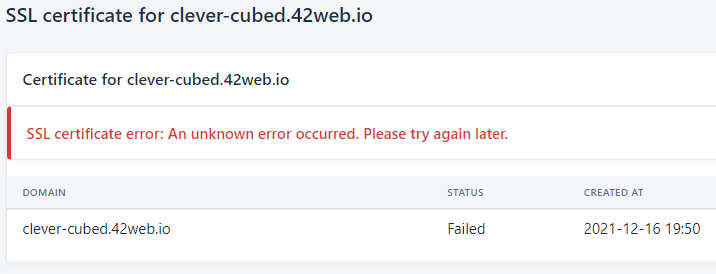

ZeroSSL keeps resulting in "SSL certificate error: An unknown error occurred. Please try again later."
epiz_26669064 - clever.42web.io
epiz_27910743 - twice-as-clever.42web.io
epiz_26669064 - clever-cubed.42web.io
All three exhibit the same behaviour.
“SSL certificate error: An unknown error occurred. Please try again later.”

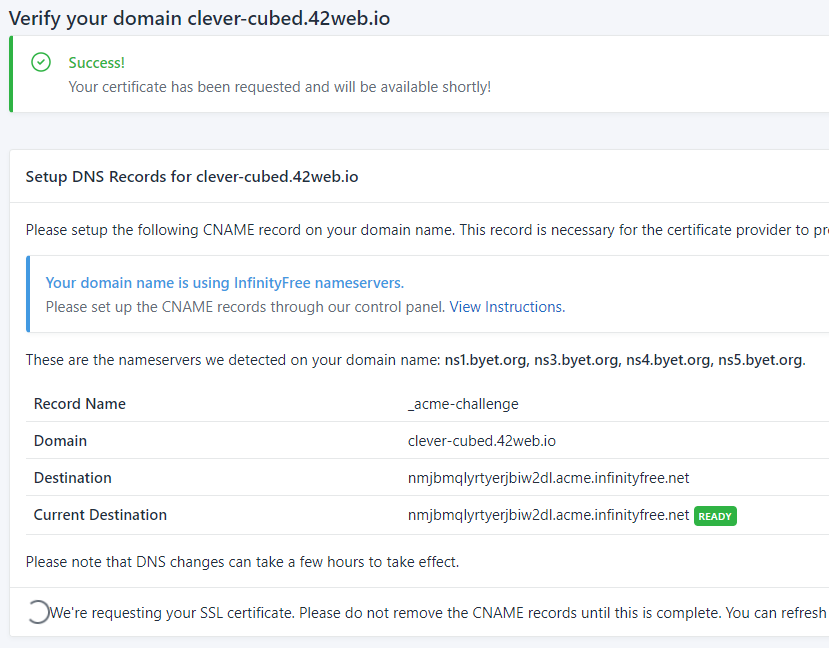

Setting CNAME went fine. But all three domains go from:
To:
I retried a few times for each domain, but same results.
I tried now issuing and installing a certificate from GoGetSSL (which I’ve used so far) for clever.42web.io, and this worked fine. Still, I’m curious to try the new service for my other two domains. Any ideas what I should try? Or perhaps the problem is on ZeroSSL side and I should just try again tomorrow?

This is some sort of bug with the SSL tool for ZeroSSL. I tried this morning :sweat_smile: and it worked, the records were same.
Very strange. Going through the logs, the problems seems to be in part that ZeroSSL is taking a REALLY long time to validate the domain name, and the third party library we’re using to talk to ZeroSSL doesn’t deal with that in a way that makes it easy for me to work around that.
I’m working on rewriting that code to prevent this from happening, but it’s big and complicated.

Please note that Cloudflare Certificates do not work here, since the control panel does not accept CA chains. The SSL generator was not working earlier due to a DNS issue, but it running properly now.

@jaikrishna.t, can you please clarify where Admin said it was fixed? He said that the code needs to be reviewed. Additionally, one can reproduce the error just by requesting a certificate!

Update: I’ve been trying it once every day, and today it worked, for both of my other domains, within a few minutes :grinning: so either ZeroSSL fixed some latency on their side, or Admin managed to fix the code on Infinity side. Either way - ZeroSSL now seems to work fine. So cool, good job, and thanks!
