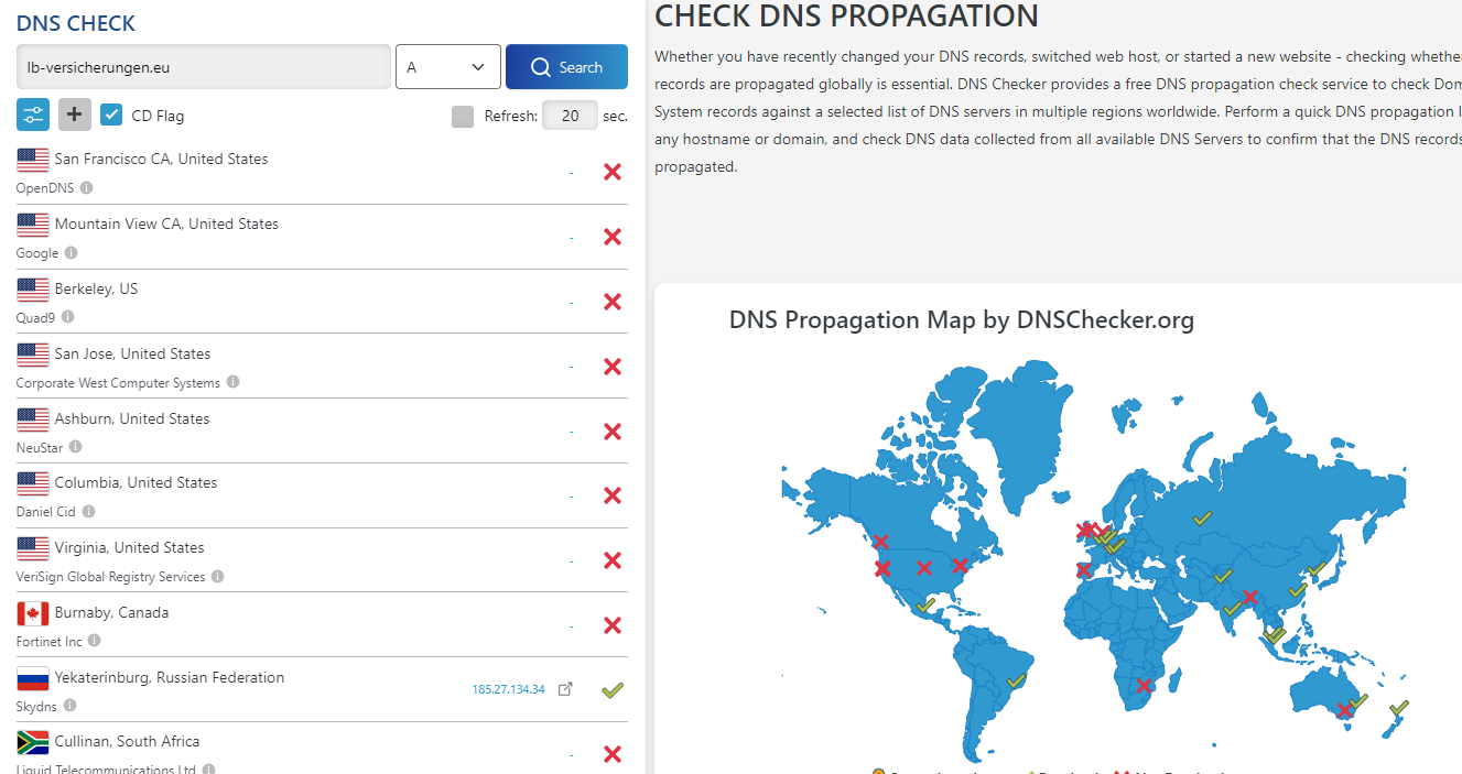

I see this
https://dnschecker.org/#A/lb-versicherungen.eu
This seems more applicable to you now
I checked your domain name and it appears to be down because DNSSEC is enabled on your domain but configured incorrectly.
DNSSEC is enabled on your domain name, but our nameservers don’t support DNSSEC and so the DNSSEC configuration for your domain name does not allow our nameservers to respond on behalf of your domain. Because of that, your domain name will be down for many people, including our SSL checker.
To fix this, please disable DNSSEC with your domain name provider for your domain.

Hmm, that’s strange. Because a DNS lookup shows that a “DS” record is present for your domain name:
The presence of this record makes it that clients who check for DNSSEC will validate that our nameservers return the right DNSSEC records for your domain, which our nameservers do not.
This DS record is usually tied to the DNSSEC switch at your domain provider, but sometimes this doesn’t work correctly.
Please contact Netim for further help with this. All I can do from my end is confirm that DNSSEC is actually enabled on your domain. Whether the DNSSEC option at your registrar works is out of my control.
Thanks. Answer from Netim: "Hello
lb-versicherungen.eu has indeed an old DS record at .EU Registry
I have removed it, so the domain should resolve shortly.
best regards"
I just checked your domain and everything appears to be fixed now! Your website is reachable and our SSL checker is now also able to see your SSL certificate.
