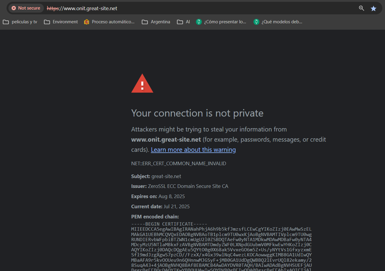

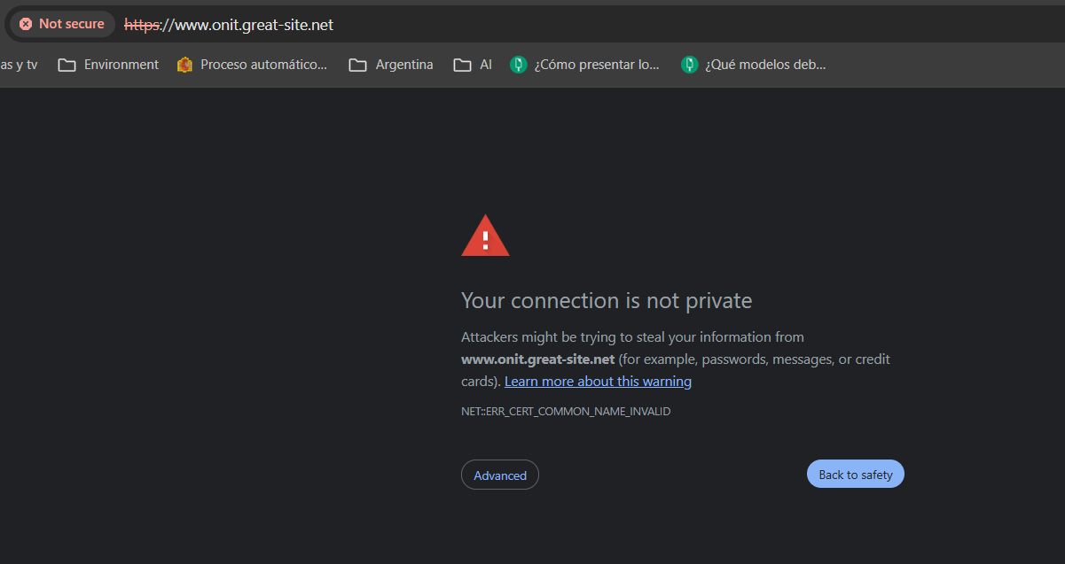

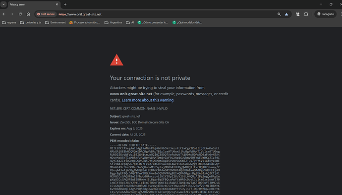

i am getting this message:
Your connection is not private
Attackers might be trying to steal your information from www.onit.great-site.net (for example, passwords, messages, or credit cards). Learn more about this warning
net::ERR_CERT_COMMON_NAME_INVALID
Subject: great-site.net
Issuer: ZeroSSL ECC Domain Secure Site CA
Expires on: Aug 8, 2025
Current date: Jul 21, 2025

This server could not prove that it is www.onit.great-site.net; its security certificate is from great-site.net. This may be caused by a misconfiguration or an attacker intercepting your connection.
Proceed to www.onit.great-site.net (unsafe)

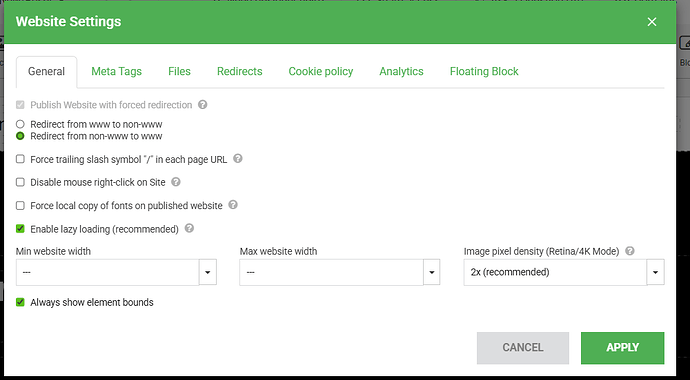

Please update your website configuration to redirect away from the www subdomain, and optionally enforce HTTPS. you can do that from the Settings → Settings → General page in Site.Pro.

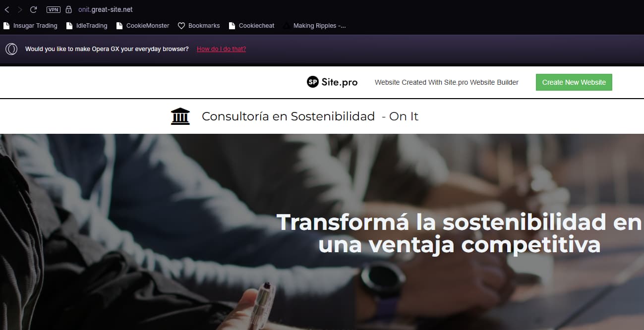

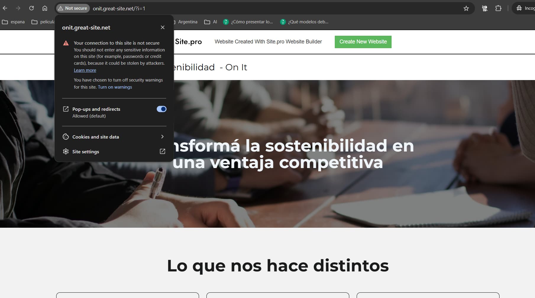

sorry to bothher, i am not following what you are saying. when i copy onit.great-site.net and paste it in google chome, it shows me this:
can you please rephrase in simpler language? i am not technical and did not understand.

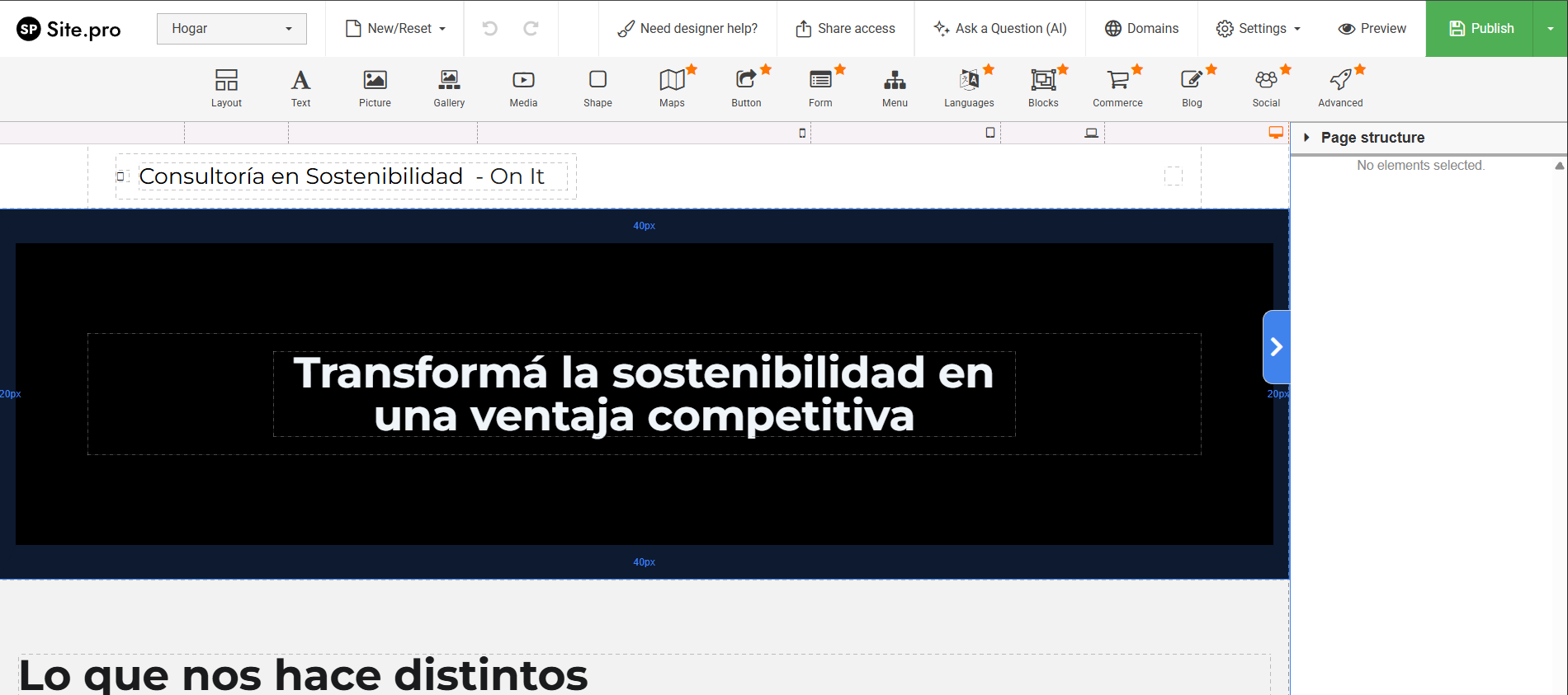

do i need to register to site.pro?
how do i do this?

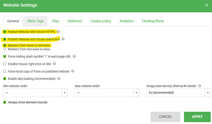

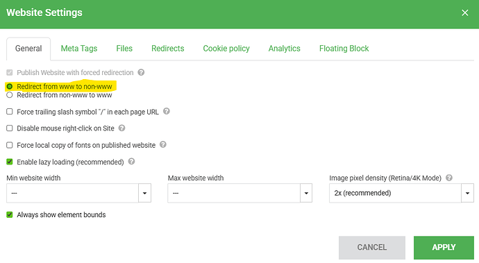

Settings is in the top right. That’s where you can make the change
is this the right place? what should i change?

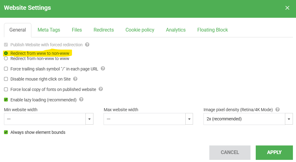

Thats it. You see that top option that says “Redirect from www to non-www”
thats the one you need to check to redirect from the www version of the site to the non-www version
is this what you mean? is the right option checked?
Yes that’s the correct option.
that will make your site redirect from https://www.onit.great-site.net/ to the one you want https://onit.great-site.net/
To see the change, you may need to clear your browser cache.
To do that press Crtl F5 on most browsers
thank you. i did this and i still get this after clearing the cache.

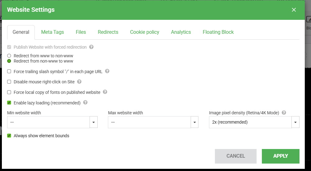

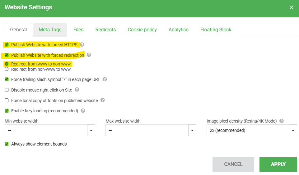

than you. so now i have it setup like this.
is this correct?
That all looks correct to me.
If you navigate directly to https://onit.great-site.net/ (make sure to remove www.) that should all be working now.
If you navigate to the www. version it will show that error, as that’s shown before the redirection

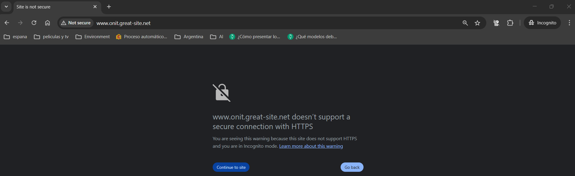

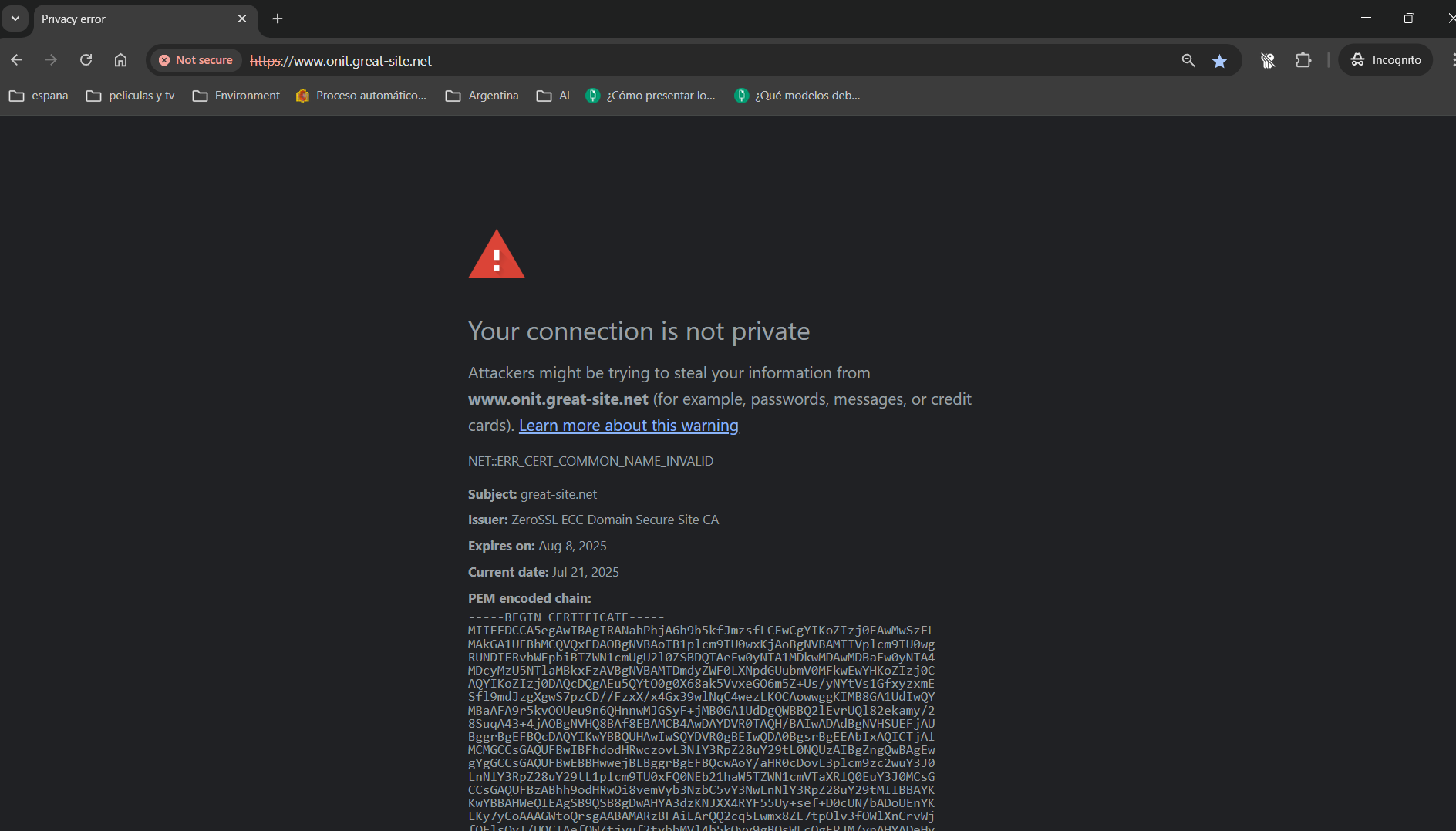

when i go to onit.great-site.net i get redirevted to https://www.onit.great-site.net/ and i see this:
am i doing anything wrong? what am i missing?

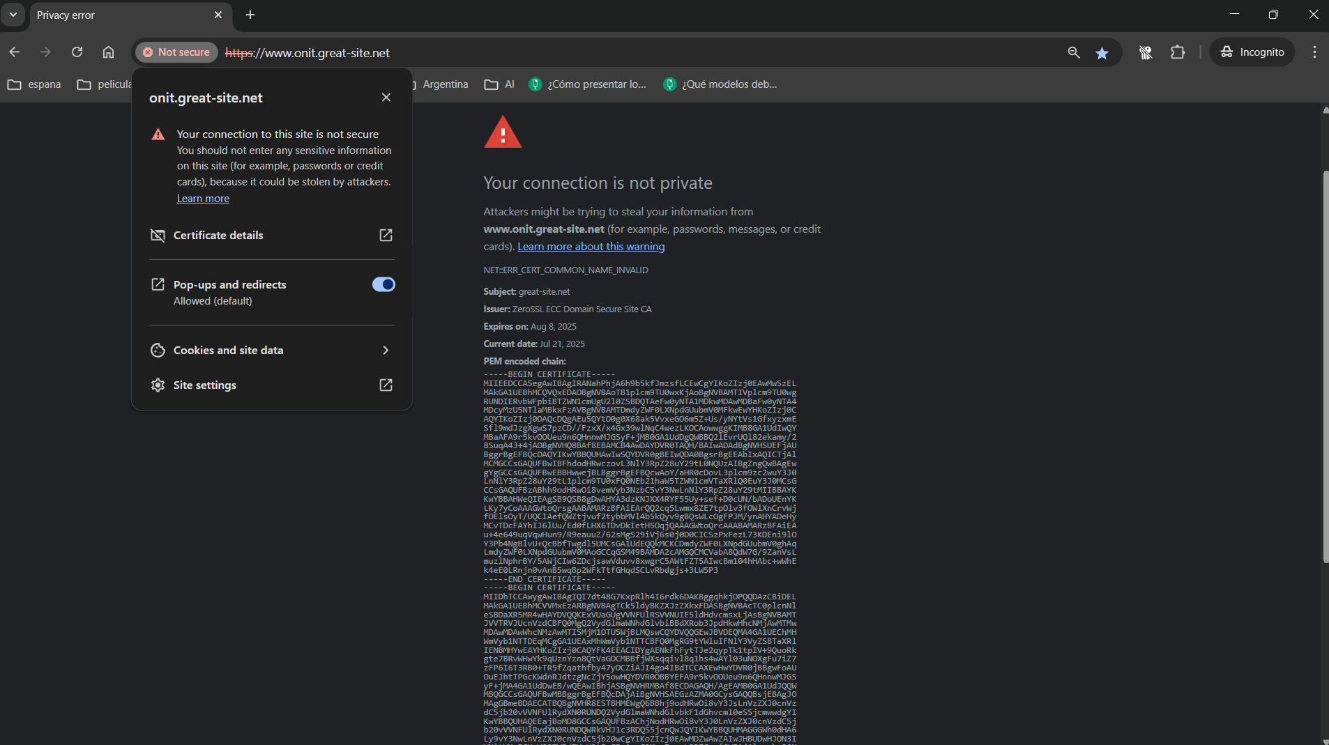

That seems like a cache issue. Try using an incognito window and see if that works.

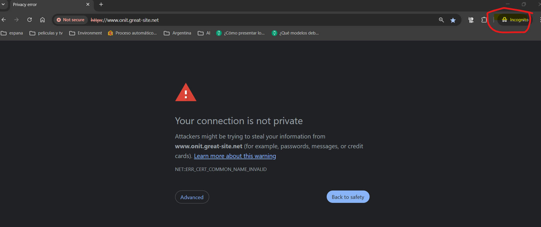

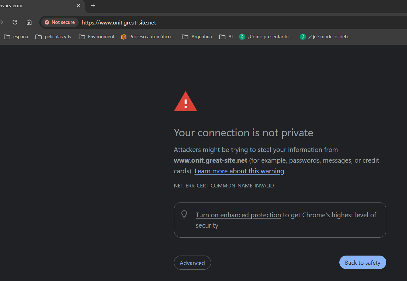

I get this as soon as I follow the correct link
i get this with incognito in google chrome.
thank you again. i cleared my cache and see the same. i tried with a friend and he was also able to access, like you.
i am still not sure why i cannot access it from my google chrome. but at least now other visitors should not have any alerts or messages discouraging them to enter my site.
