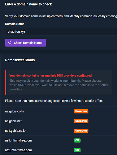

I see this; please make sure the only nameservers configured for your domain are the InfinityFree ones:
Having a quick look at your website, all pages seem to work (some require me to login). Which pages are facing the issue?
Which was what I told here as well:
I think I noticed the problem! You’re using two sets of nameservers on the domain:
[Screenshot 2024-01-06 alle 14.35.08]
The first ones aren’t right, while the second set is right! Decide which nameservers you’re going to use, and only keep a set (so keep our nameservers and remove the Gabia ones).

Oh, I’m sorry. But Gabia is where I buy my domain, do I have to delete it??
You don’t have to delete the domain from the registrar (so from Gabia); you’ll only have to remove the Gabia nameservers and keep our ones for your domain. Anyway, as for this:
Did you make sure to enable Display Errors by following the guide @ChrisPAR shared to you?
That’s odd, the website doesn’t seem to load for me.
That’s because of the nameserver mixup; when it is corrected, you should be able to view it.
If I delete the Gabia name server, can’t Gabia manage the system domain?
Gabia has still control of your domain; if you remove their nameservers you’ll only not be able to change the DNS records through their dashboard, which might be needed if you might buy an email address from them eventually, but for the rest it’ll still stay on your account at Gabia; we aren’t a domain registrar, so there’s no need to transfer your domain to us nor can you do that.
