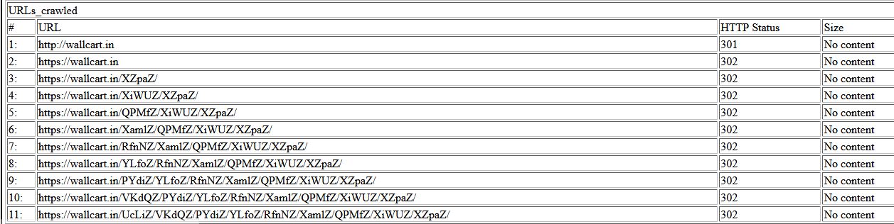

now my wordpress admin panel showing white screen when i am going for login
whether your site is infected or has some issues
there are some strange redirects
Request 1: https://wallcart.in/wp-admin/
URL: https://wallcart.in/wp-admin/
Host: wallcart.in
IP: 104.18.45.170
Error / Status Code: 302
Response Headers: RANDOM
status: 302
location: /KnagZ/wp-admin/

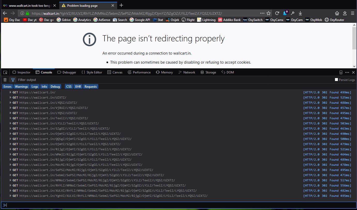

The domain doesn’t seem to be hosted by us, I see some unusual data in the response which isn’t normally sent by our systems or by WordPress. Can you please check your DNS settings in Cloudflare and verify the IP address configured for your domain matches what you find following this guide?
i am using cloudflare in betwen hosting and domain not from infinity panel direct from cloudflair. com so may be it is a problem
and i have added cloud flare name servers in my domain name not for infinityfree
OMG ![]()
Within 10 hours I have seen more than 5 versions of the problem
from CF ray with DNS errors and some 5xx
to a white page that actually does this if you click ctrl + F5
