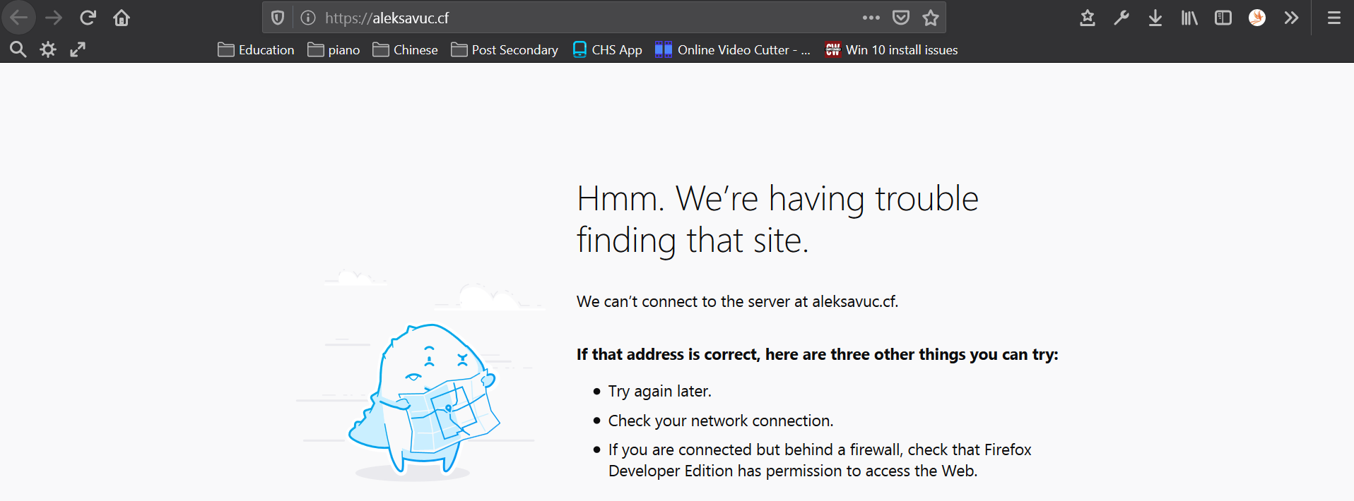

It says that the server is not found. Check nameservers. To make sure they are set to InfinityFree’s nameserver.
My nameservers:
NS1.EPIZY.COM
NS2.EPIZY.COM
https://aleksavuc.cf/ is working fine while https://www.aleksavuc.cf/ does not.
Um, it doesn’t work for me.
I just tried using firefox (I use chrome by default) and (https://aleksavuc.cf/) is still working while (https://www.aleksavuc.cf/) not works.
How old is the site (From creation)? If it is less than 72 hours, I will have to wait.
Site was made 24 hours ago.
Update: just aleksavuc.cf with https:// works for me now. http:// or www. does not work anymore. If I remove my .htaccess file everything will work exept it will not redirect to SSL version.
Update: I just tested https:// version of the site and it is not working after couple of times refreshng page. I guess i will just remove .htaccess file if no one gives me solution.
