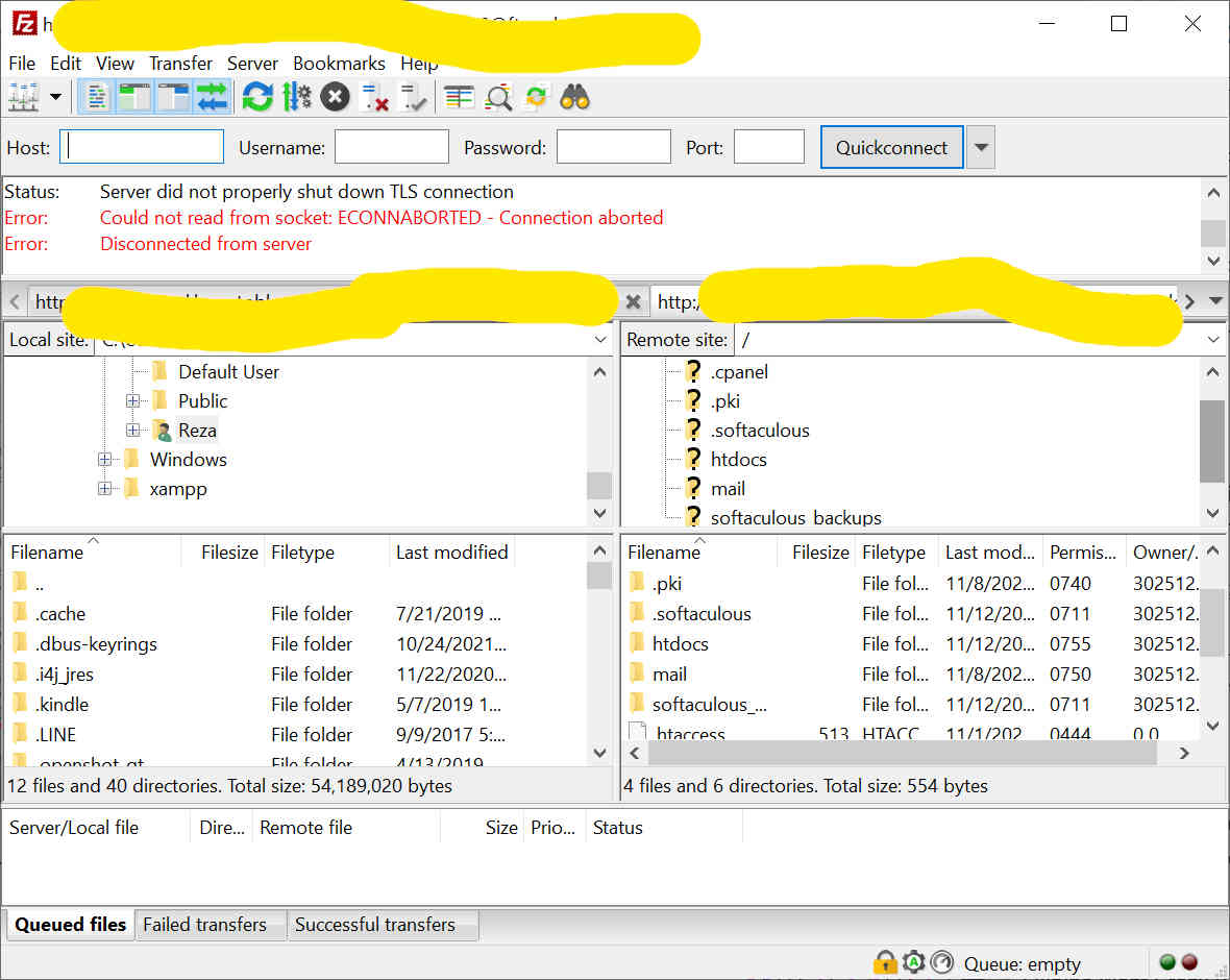

  1. As you see there is a problem with the connection. First, the size is about 180MB, was it the reason? please see the picture. 2. should I make a folder anywhere on my hard drive then which folder from your server should I drag to my hard drive?!

No idea, since you did not write clearly
Did you try these?
It seems I waited a few min after connecting to the server, I did this again and this time immediately I dragged the htdocs folder to my hard drive, this time no error message. it is still downloading. My question is once this is complete, I can always drag the backup folder (htdocs on my hard drive) to htdocs on the server to overwrite the files on the service?!
Sure
