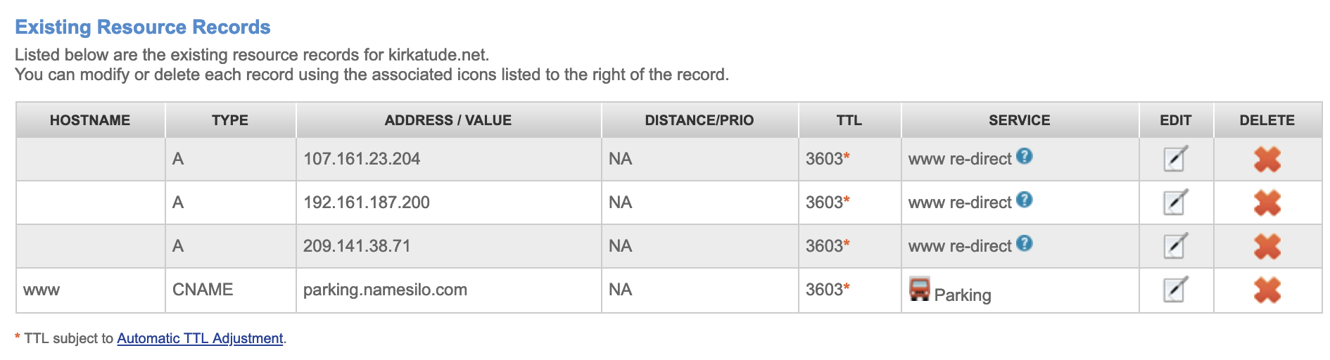

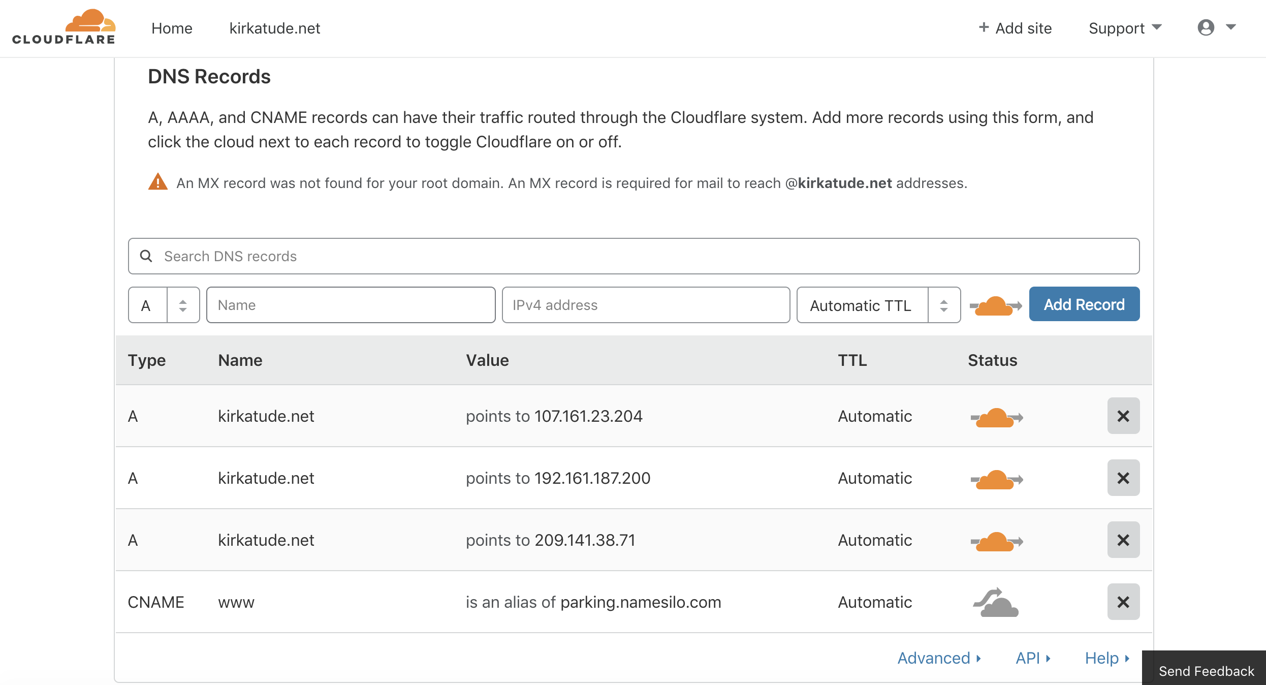

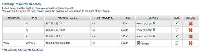

Hello. I went to CloudFlare where I have my DNS and clicked on, turned off, the cloud pointing using Namesilo, which is where I bought my domain. There seems to be 3 other “points leading to” my address. I don’t know if one of them is my ip address since I don’t know what that is. Should I delete the CNAME in Namesilo where my address seems to be parked? See the attached screenshots.
totally wrong ![]()
from your previous statements
your domain has been added to our system and you have a folder with its name…
if that is correct than OK
- Login to the Cloudflare account
- Select the domain from your account list.
- In the Overview app, go to the Advanced section.
- Scroll down to Advanced Actions located in the vertical list of links on the right side of the UI
- Click Remove Site from Cloudflare.
- Click Confirm.
then go to NameSilo
and instead of cloudflare NS put ours https://infinityfree.net/support/how-to-use-infinityfree-nameservers/

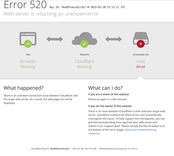

Thank you for your patience and help with this. My website is up and running. I just thought that when I changed my NS’s to Cloudflare’s, that that would make my website secure (https). Is there something else I need do to make that happen? I received that attached from CloudFlare. Thanks, Kirk.
Please make sure your website is fully configured to use HTTPS URLs. If your website supports HTTPS, it should use HTTPS
make sure you update your Website URL in the WordPress settings first.
without www in your case
Then on Cloudflare set SSL FULL
for all other settings, read help in the CF dashboard
than wait and after 1h you can try to visit your domain
it should automatically jump to https (WP will do it)

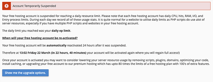

Well, my website finally went to https by enabling the CloudFlare plug-in in Wordpress. An hour later I got this Entry Process Limit notification, and my site is disabled for 24 hours. Huh?
if it repeats - it would be good to remove all unnecessary plugins
https://infinityfree.net/support/entry-process-limit/

Which seems to have worked, but for something happening to my daily ep limit.
Hense, I now have to wait 24 hours to see if it happens again before I can do anything about it. Hmmmm. Kirk

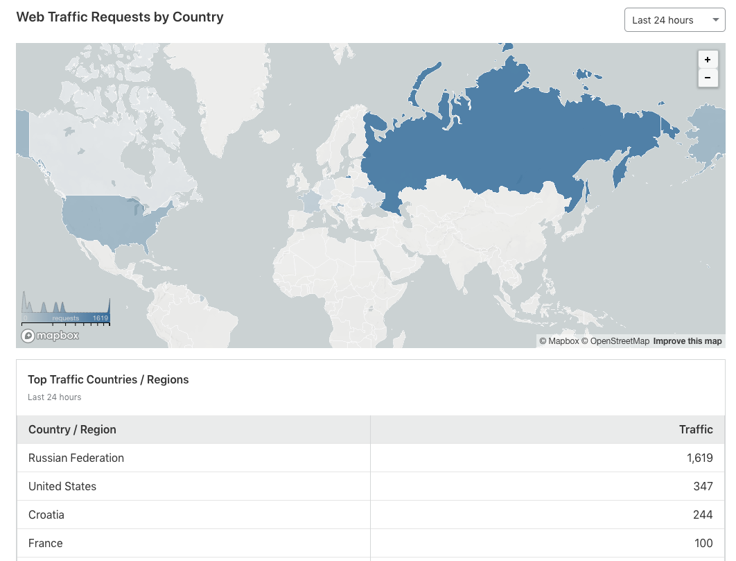

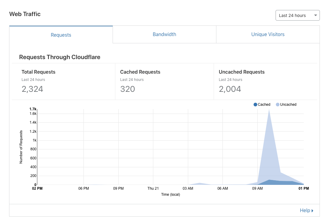

I found the attached info from my CloudFlare account. Does this have anything to do with it, that you might know of? This happened right after I used the CloudFlare plug-in for Wordpress. Thanks for your attention. Kirk

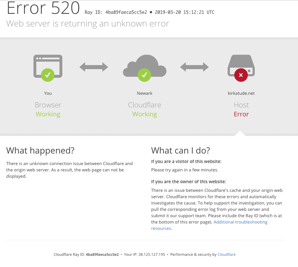

CloudFlare didn’t work because the NS settings they pulled were wrong
Plugin or not - both uses and communicates with the same destination (CloudFlare)
The number shown is not to be concerned
What I think is happened:
You chose the wrong SSL or the default setting was incorrect (like SSL strict or Flex instead of Full)
And that is caused a CF error 520
and the plugin is then either hang or has done extra communication and worked longer than is provided/allowed - which caused the spike and suspension
But I do not know how that plugin works and all these my words are pure speculation without testing or evidence

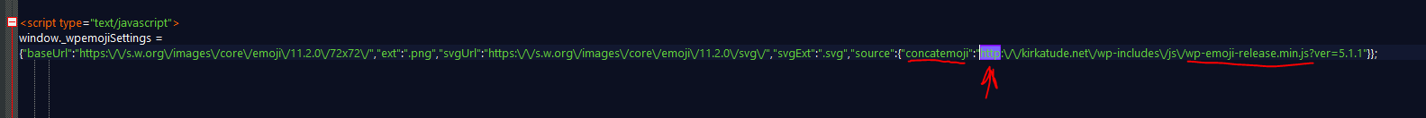

I’m more concerned right now why does this URL inside a JS script from WP
is located on http instead of httpS
and that was the reason why I asked you to do a “purge cache” (but it did not help)
Try to check if you can find anything in the Dashboard of WP, and if not one of the solutions is
That Russian traffic spike looks like it could be the cause of the suspension. If, say, a botnet attacks your website, trying to break in or publish spam comments, then that can generate a very high load on your website.
