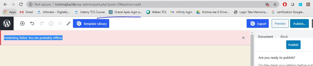

Once i click on Publish button to publish the New Post I am getting below error.
Publishing failed. You are probably offline.
PFA - The Screen Shot of the error for your reference.

I suspect this error is being caused by the fact that you’re using Cloudflare with their “Automatic HTTPS Rewrites”. This is why we recommend against using such “magic fixing options”, because they have a tendency to break in strange ways.
Can you please try to configure your website like this instead and see if that works?
https://infinityfree.net/support/wordpress-and-cloudflare-flexible-ssl/
