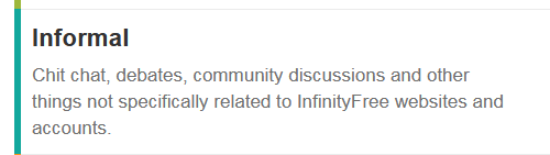

@wackyblackie I posted it here in informal because everyone here is so helpful and informal category says this
Yes, sorry! I was mistaken.
thats cool, it proves youre human ![]()
but thanks , youre always so helpful
