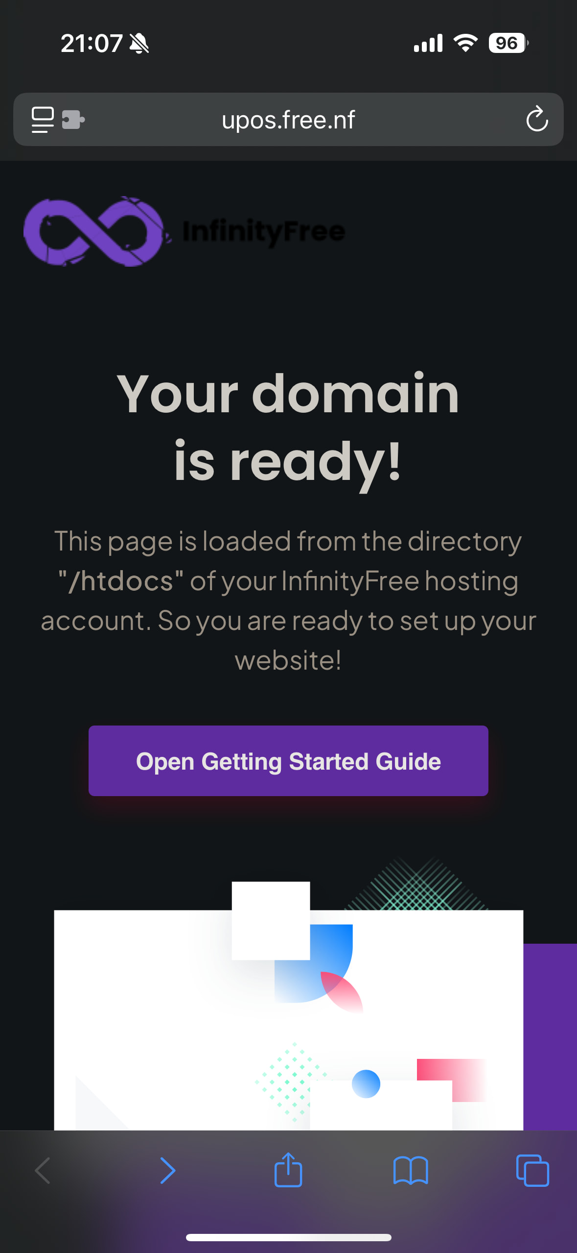

when we use codeigniter4-framework-v4.6.4-0-ge4d3702 it gives forbidden error while when we use codeIgniter-3.1.13-0-gbcb17eb display so many errors related to framework
in both case i simply codeigniter zip file upload and extract. how it would be solved
You have not uploaded your site yet, try extracting your zip on your local computer and uploading the folder containing the files. If that doesn’t work, use a better FTP client, like FileZilla.

Even to this point we are not seeing any errors, just a default landing page.
Could you please at least share on which URL did you get that 403 error?
