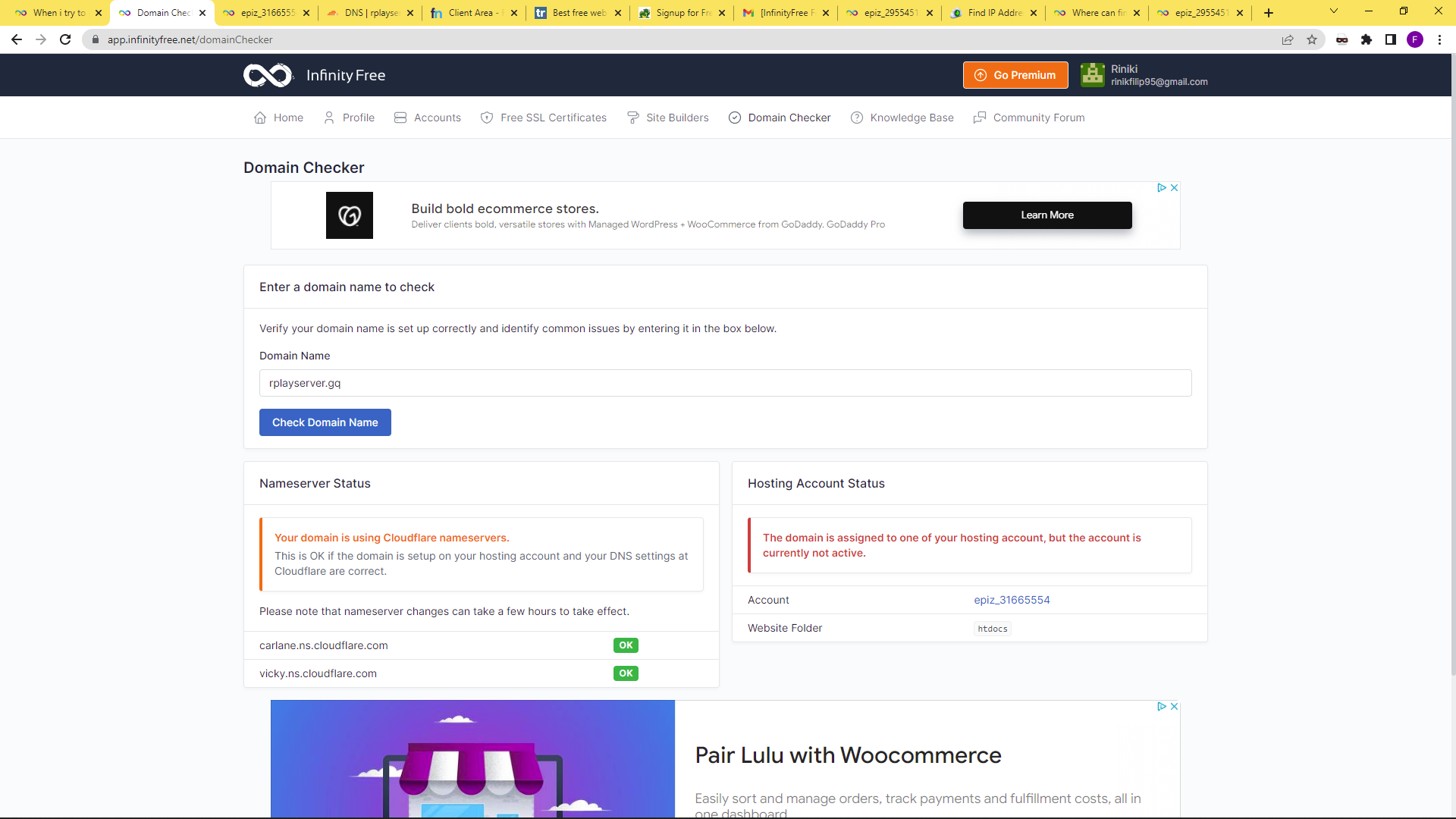

It’s not impossable, just confusing. Please enter your domain name into this link, it will tell you what account it is connected to.
it is connected to cloudflare
Yes, but I thought you wanted it connected to InfinityFree, right???
If you want to manage it with InfinityFree, you need to get the correct IP address from the account that it is actually connected to, not some random one off your profile. Look at my last post, I told you how you can do this.

what account?
Hosting account.
I think that explains it, no? The account is not active, so of course its not going to work!
