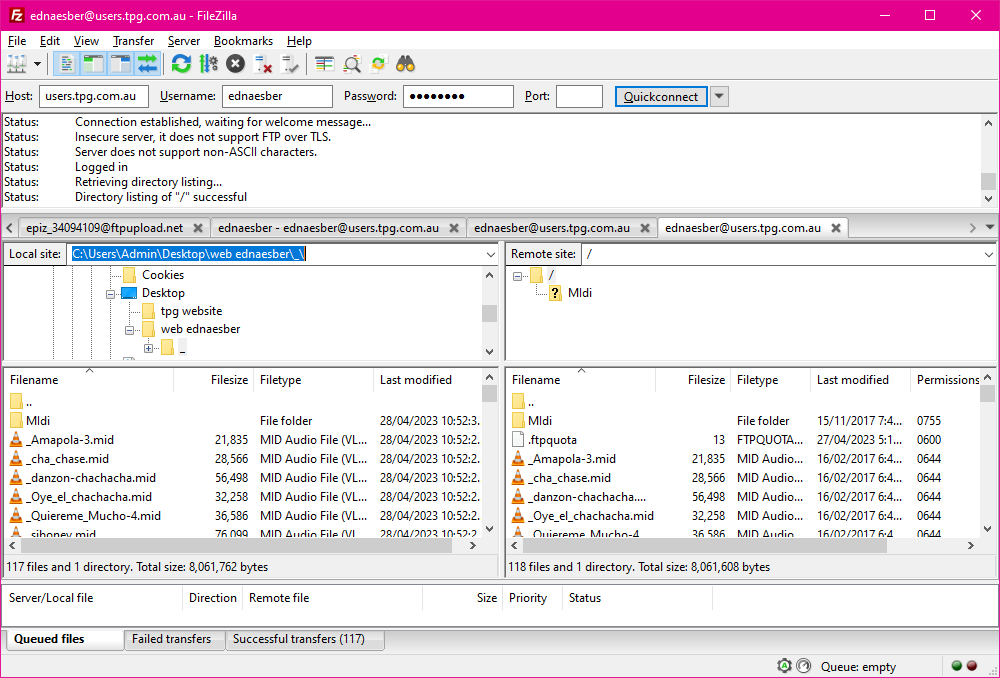

Please screenshot file structure of website
Hi Kang what will I ask tpg to send me what file so you will know the answer?
What you have screenshot is the file structure of the previous host.
I need you to show that of the current host
sorry i dont understand. You are my current host isnt it?
InfinityFree is the current host
Seeing how I currently see our default welcome page on your site while you said you uploaded files, I think this article is relevant for you:
The first thing to check under the “I already uploaded a website, why don’t I see it” is “Make sure to upload your files to the htdocs folder”. And I’ve checked your account, and I see that’s where you went wrong.
Please make sure to upload your website files to the folder called htdocs. Files uploaded anywhere else, including the root folder of your account, are not picked up on your site.
