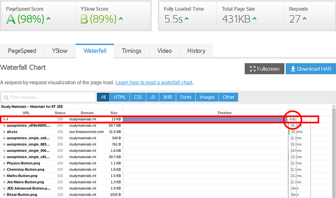

I Dont know why my website having 4.8 seconds load time.
I use to have a overall load time of 2.3s. I am having this problem since i migrated my site to another new account of same infinity free because i messed up with my ftp.
Could any one tell what went wrong??

My website URL is: studymaterials.ml
What I’m seeing is: a wait time of 4.8 sec
I’m using this software: Wordpress

I can’t tell you exactly why your website is slow, but as some general information:
  • WordPress can be quite fast or extremely slow depending on how the site is configured. Having a poorly coded theme or plugin can really wreck your page load times with inefficient code and database queries.
  • Even if you don’t have a bad plugin or theme, simply the number of plugins can also cause load issues.
  • You can try to use a profiler on your site to see what might be causing these issues. P3 is generally highly recommended, but seems unmaintained. This article lists some alternatives. I don’t have experience with any of them, but feel free to try them and please do share your experience! 11 Free Alternative WordPress plugins for P3 (Plugin Performance Profiler)
  • If you haven’t done so yet, installing a caching plugin can be useful to help reduce the number of code to be executed for most requests.
  • I see your website is using Cloudflare. While Cloudflare makes websites faster, using Cloudflare actually increases TTFB on the main page. But since Cloudflare caches and compresses many things, the end result is a faster site, even though not every metric is improved. Cloudflare also has an article about this: https://blog.cloudflare.com/ttfb-time-to-first-byte-considered-meaningles/

Enabling Cloudflare compression probably won’t help too much with the load times. In the waterfall chart, you can see almost all files load in a few milliseconds, except for the main page. Which makes me suspect the bottleneck is in the WordPress code.
I don’t know which performance profiler plugins are easy to use, but I do suspect that a bad plugin or theme is causing these issues. If you have a plugin to analyze the performance impact of plugins, that would help a lot. And if you have any trouble interpreting the results, maybe you can share them here so we can look at it for you?
Specifically regarding Query Monitor, are there any queries which take a lot of time? Which queries are this, how long do they take, and which plugins or themes generate these queries?
