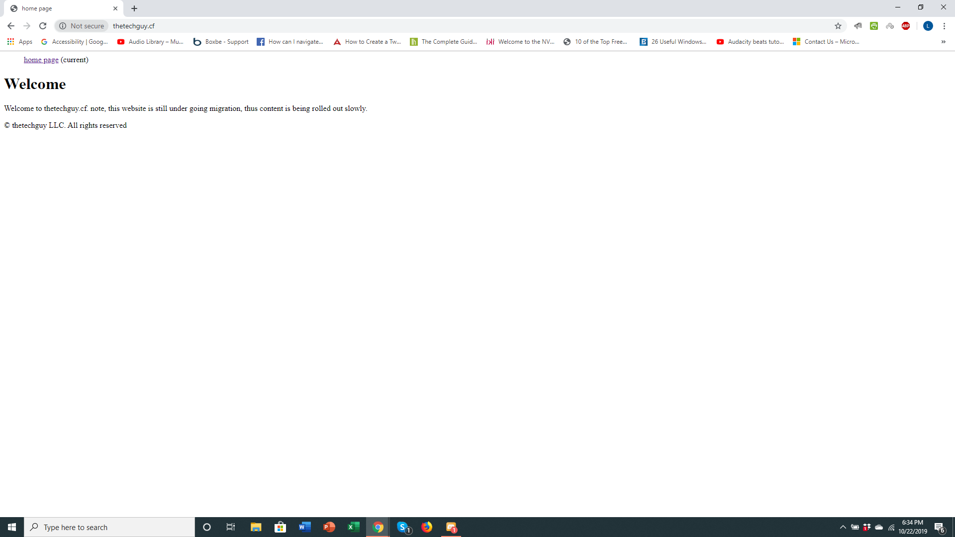

hi,
My website URL is:
https://thetechguy.cf and https://beta.thetechguy.cf
What I’m seeing is:
There is no padlock icon in the browser when i go to https://beta.thetechguy.cf but there is a padlock icon when i go to https://thetechguy.cf
I’m using this software:
google chrome
I appreciate any help.
I also see this now:
This server could not prove that it is beta.thetechguy.cf; its security certificate is not trusted by your computer's operating system. This may be caused by a misconfiguration or an attacker intercepting your connection.

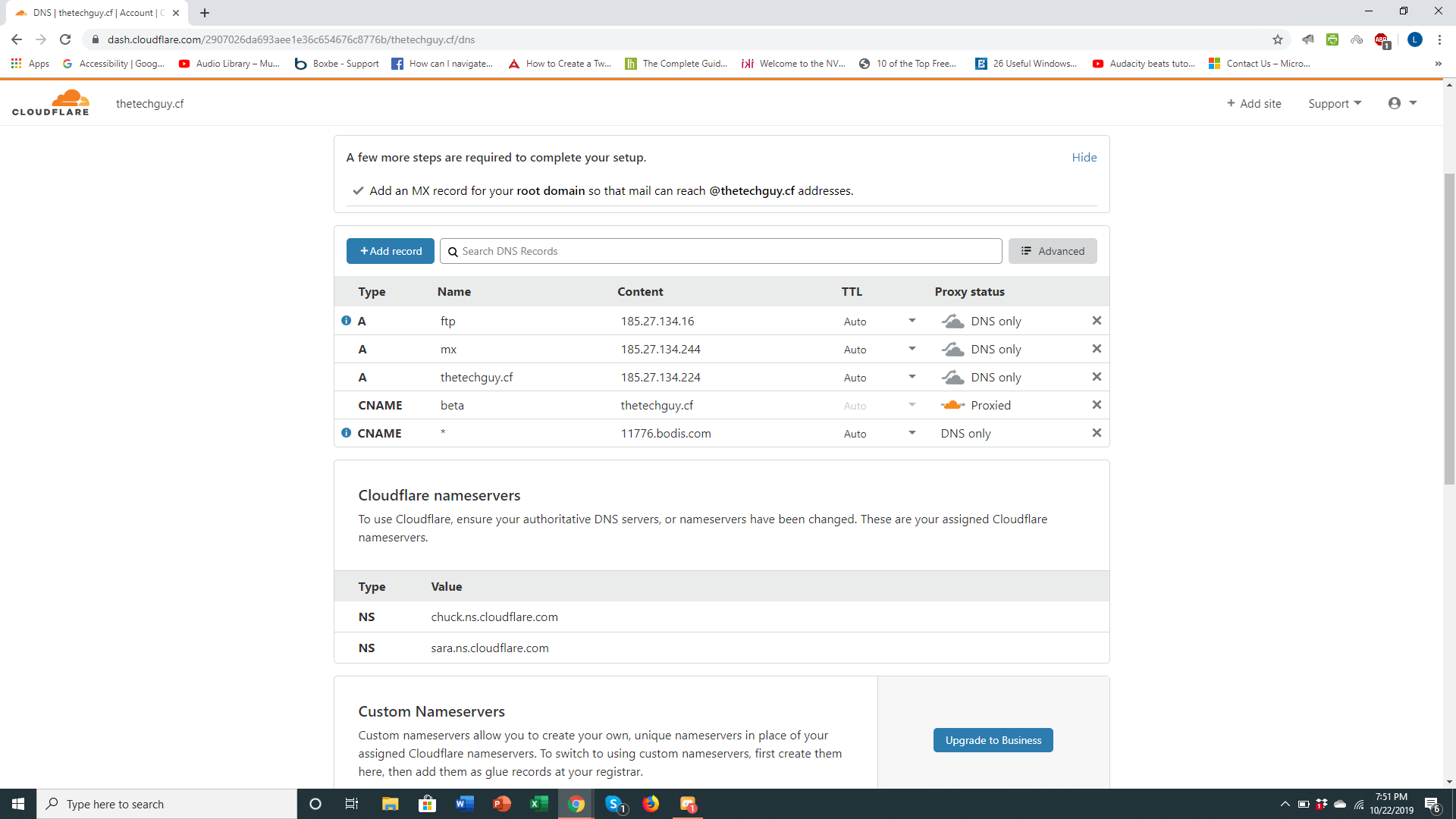

well this is what my DNS page on cloudflare looks like. I have enabled the always use https://
I checked, and the record for your domain has the grey cloud. Enable it.
I also suggest to add a CNAME record with name www and value @, so it would be also accessible with www. before the domain.
Do I just click the grey cloud?
Yes, you do.
Thank you for the help.
After I see your records, I suggest like this:
A - thetechguy.cf - (keep its IP) - Proxied
CNAME - www - thetechguy.cf - Proxied
A - beta - (same IP with main domain) - Proxied
MX - thetechguy.cf - mx.epizy.com - 0 - DNS only
ftp & mx name keep like that (A records with grey cloud). Or you can remove them if unused.
beta & * CNAME record can be removed safely. Maybe you must remove beta CNAME first, before add beta A record.

@anon99413185, I think the record for mx points to the same IP of the webmail, which I think is not correct, and ftp should point to 185.27.134.11 instead of the IP there was before.
@anon18472063, so you should remove the mx A record, put a MX record for your domain that points to mx.epizy.com with priority 10, not 0, and correct the ftp record value with the IP address 185.27.134.11 instead of the one there was before.
