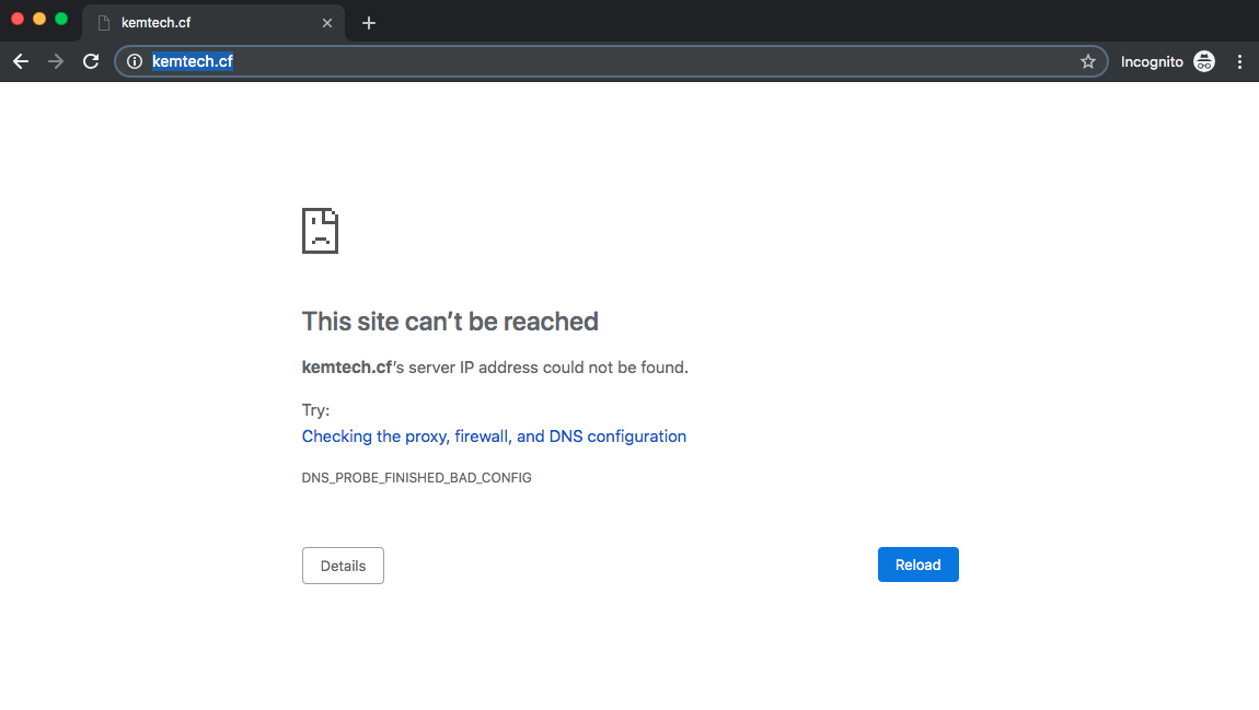

I added 1.1.1.1 DNS to my Mac because I had already done the DNS caching. But I did it a second time to be sure. It showed on my laptop for one day then started with the DNS issues again. Now when I type in kemtech.cf in incognito I get the below page, and a icon saying resolving host. and nothing happens.
  1. If I type in kemtech.cf on my work laptop it takes me to a google search. (its impossible for me to do a DNS cache on every system in the world) I asked a friend of mine whom I knew had not visit the site to search it, and it is taking them to a search engine page for kemtech.cf no website.
  2. www.kemtech.cf is not working on mobile devices for Samsung devices. It is being sent to a google search. On iPhone, Safari: can’t open the page because the server cannot be found.
This is what is shown when typing kemtech.cf in incognito. Remember I have already done the caching issues and added the 1.1.1.1. Worked for 1 day only. I did not change anything to make it revert back, as I know it will be said it is something on my end.
If it’s being sent to a Google search, please check how your browser interprets what you enter. Most browsers have an “omni bar” which means you can enter URLs and search queries in the same bar. The browser should then recognize whether you’ve entered a URL or a search query, and handle it appropriately.
If you enter a domain name and see search results, that means your browser does not recognize what you’ve entered as a website. If so, double check you didn’t add any space characters to what you’ve entered, or try to enter http://kemtech.cf instead.
