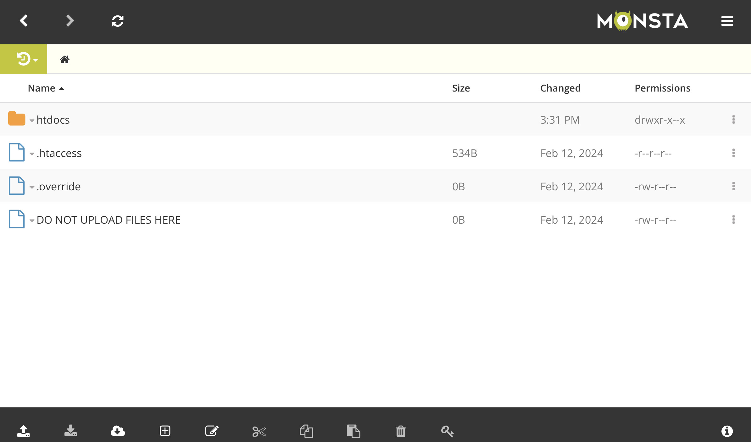

Can you show the / directory ?

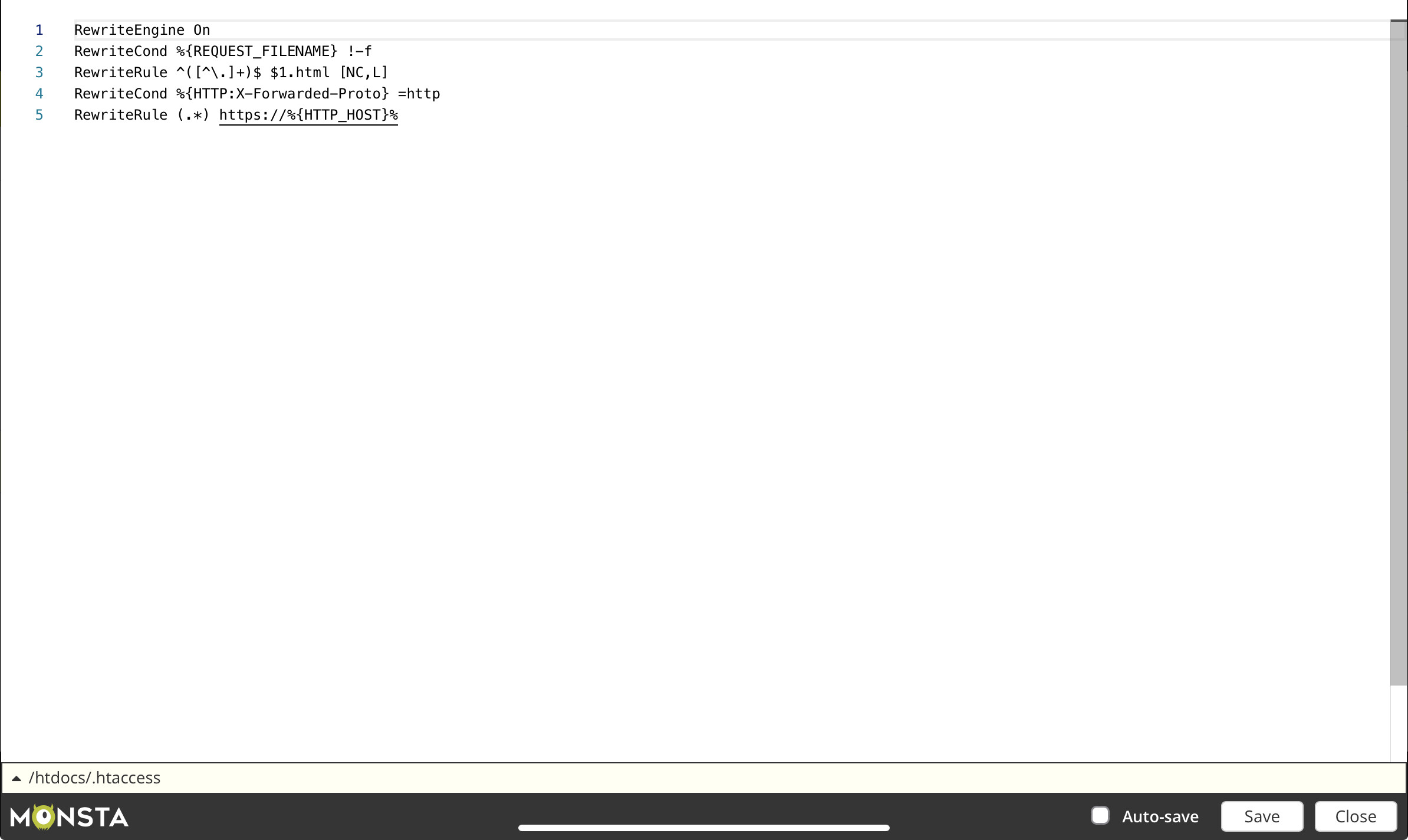

Can you confirm you are using the correct .htaccess?

There is my own .htaccess file.
Just
DirectoryIndex index.html
will do.
No redirect is needed. This is the default behaviour of the hosting account.
If you remove your code. Website should work as intended
Write it in what file? I tried to write it in .htaccess line 2, but it doesn’t work.
Just remove the whole thing.
Anyway your code is wrong
It still doesn’t work. What should I do?
For me your website now works fine. If it doesn’t work for you, please clear your browser cache by pressing Ctrl+F5 while visiting your website; if that doesn’t work (because some browsers are stubborn) then follow this:

I suspect the wrong .htaccess is present in download folder
you probably have it in your browser’s cache because it leads to 403
