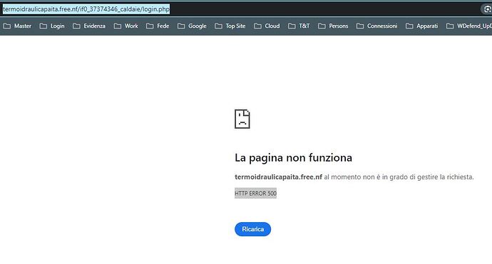

Greetings to the forum, a few days ago I registered on the site to test a web application developed in PHP that works quietly in my localhost with the following characteristics:
  • Apache/2.4.25 (Win64) PHP/5.3.13
  • Versione del client del database: libmysql - mysqlnd 5.0.8-dev - 20102224 - $Id: 65fe78e70ce53d27a6cd578597722950e490b0d0 $
  • Estensioni PHP: mysqli
    I just transferred the entire web application to my InfinityFree site by copying it into a subfolder of htdocs but if I try to start the web application by calling the following link: (termoidraulicapaita.free.nf/if0_37374346_caldaie/login.php
    )] it doesn’t start and gives me the HTTP ERROR 500 error. What could this depend on? Thanks
