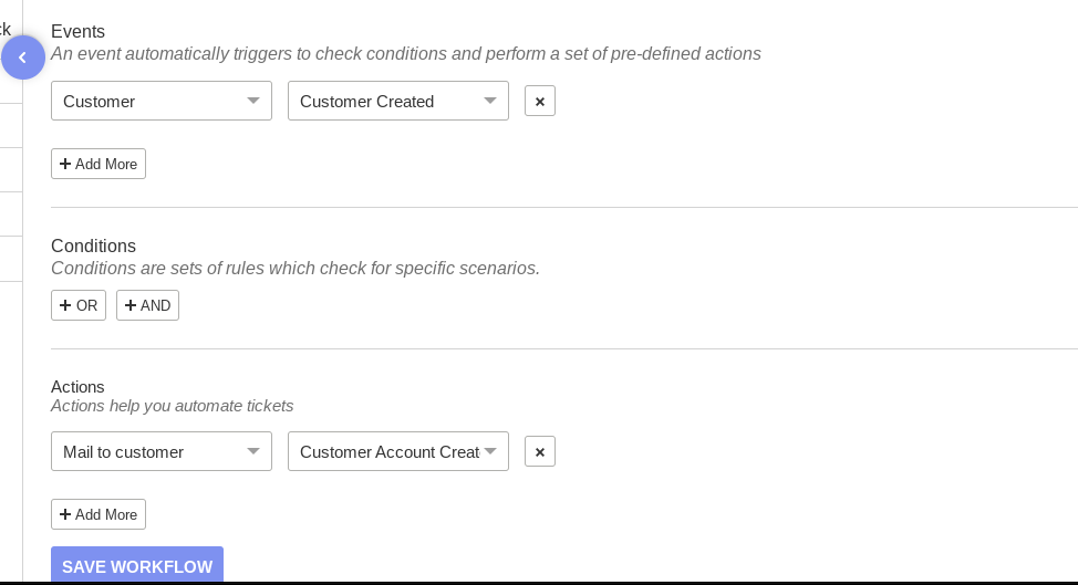

The workflow looks something like:
See for example, if it is the first time for the user creating a ticket, it should send them an email like:
{%global.companyLogo%}
Thank you for joining!!
Hello {%user.userName%},
Your account has been successfully created. We welcome you to the community of {%global.companyName%}.
It is our privilege to have you as our customer. We are pretty much sure that you will love the fact that how simple it is to get started with the services. We are dedicated to making your working life simpler.
Click on the link to set your password {%user.accountValidationLink%}  and get started with the {%global.companyName%}  services.
Hoping that you will enjoy this experience.
Thanks and Regards
