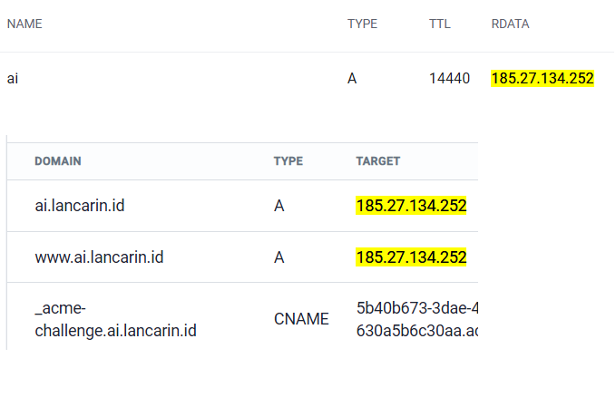

I’m not sure if the image shows correctly here. I have A record added (I think i added this when I first used Infinityfree last year). Is there anything else that I’m missing?

From the picture you seem to be putting A record correctly, but your domain uses idcloudhosting
nameservers at the moment, and that nameserver is having problems with either bad horizontal referral
or lame delegation
error message. Since you’re on custom domain, you may try switching nameservers to cloudflare.
