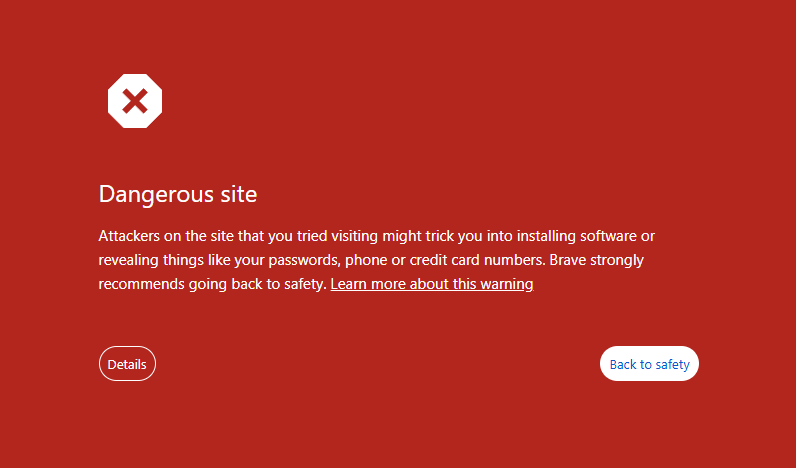

The SSL is working fine on your site (as long as you go to the https version)
However, I am getting the safe browsing error that looks like this:
This isn’t anything to do with the SSL

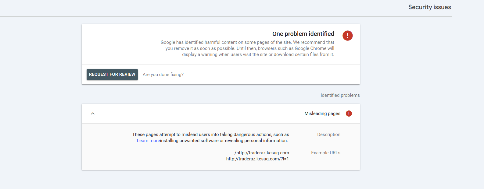

this is what it write to me for why my website is blocked.
do you know what is the param i at the url?
the i parameter is part of the security stystem.
However, I think the bigger problem is that your site drops straight into a login page with no explanation.
Personally, I’d add a landing page, which then leads to the log-in page.
Also might be worth setting up a HTTPS redirect
Like Dan said, it’s not flagging the “i” GET param, it’s flagging the contents of the page. Your site leads directly to a login page with no brand name, logo, or any pages other then login/signup/forgot password. Google considers this spam (As a lot of websites like this are phishing scams). Don’t make your login page your default page, and add some unique branding to the site.
