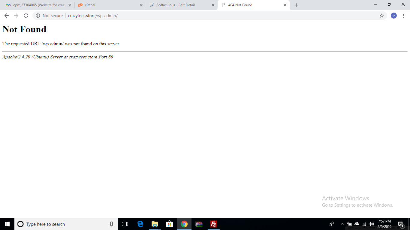

@anon52236679 I tried to add domain in another account but after installing wordpress when I’m trying to login I’m getting this error. The requested URL /wp-admin/ was not found on this server.

@anon52236679 I did. Still I’m getting same error. http://crazytees.store/wp-admin/ . My domain is crazytees,store
@anon52236679 I’m getting this error. Not Found
Your website and /wp-admin/ directory is fully accessable from my device.
Therefore it is installed, mark this reply as solved.
Why I’m not able to access?

@anon6897566 you need to force refresh (Ctrl + F5 in Google Chrome) the webpage, see if it loads the page.
@anon55589970 I’m trying again and again. I tried in internet explorer also but still same issue.
That error page is not from our servers. It says Apache 2.4.29 running on Ubuntu. We don’t run Ubuntu and we don’t run that specific version of Apache.
Your website is working fine from here and your DNS settings look OK. Do you experience this issue on other devices. Have you edited the hosts file on your computer before?
