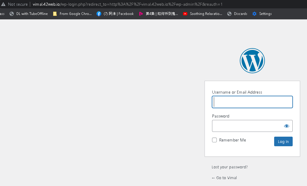

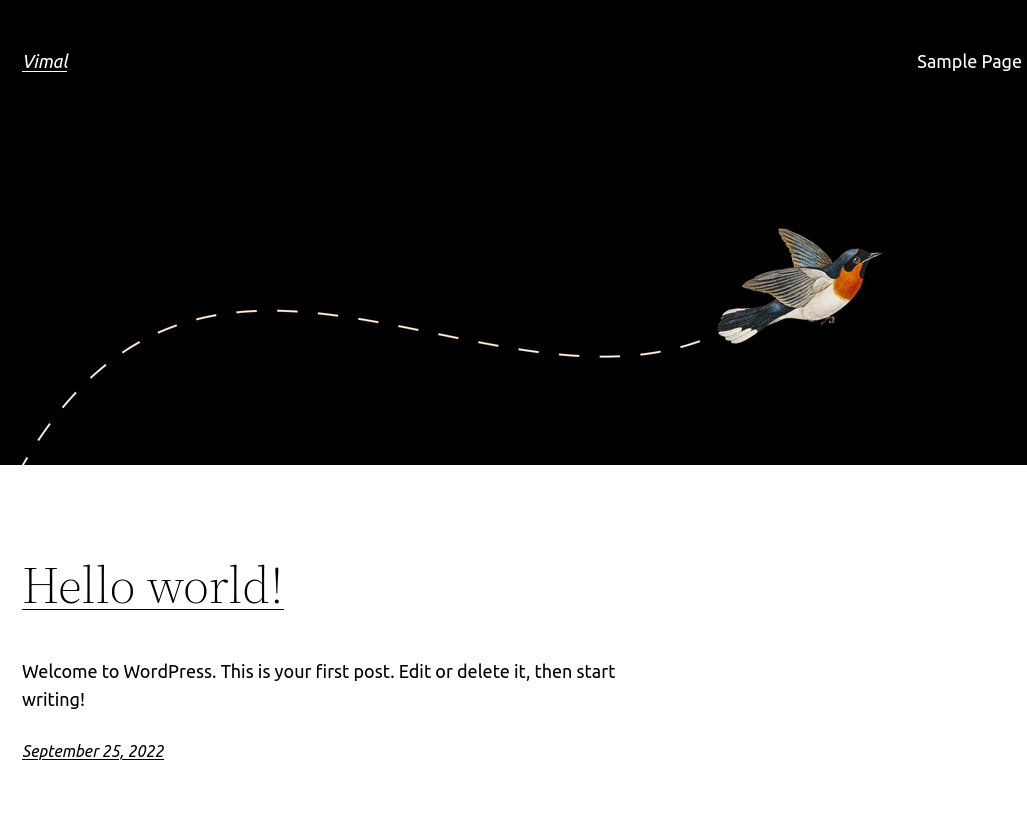

Domain works fine for me:
Working for me as well
