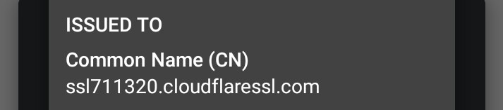

Hi there,
If you are using a certificate from Cloudflare then it won’t work with your domain because you see the common name of Cloudflare’s SSL certificates is not registered to your domain name and the way InfinityFree verifies that it is your SSL certificate is to check the common name, if the common name is not registered to your domain name it won’t work.
You can install a Let’s Encrypt SSL (You can issue one for your TLD by going to the InfinityFree Dashboard and under the SSL certificates option) certificate though and Full (strict) should work because you have now an SSL certificate installed on the origin server.
Hope this helps!
