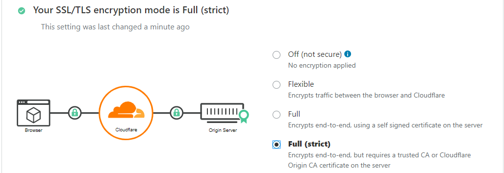

I tried with the Flexible option but still having the ERR_SSL_PROTOCOL_ERROR when calling with https but the page is still responding with http. I tried with Flexible, Full and Full Strict with the same results. Now is set in Full Strict.
My intention is to have (https) a secure channel and Full Strict is the ideal. By reading several posts I found that putting CloudFlare in the middle, helps me to have free ssl certificate that CloudFlare renew automatically. They mention:
Full Strict requires a trusted CA or Cloudflare Origin CA certificate on the server

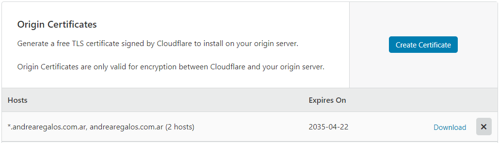

That I created.
But when I tried to upload here in the SSL section I get:
And I’m lost again …
What I’m doing wrong?
I asked for this error in their comunity and someone told me:
“The error message here will be because the certificate won’t contain the domains in the CN but only in the SANs, but there is perfectly okay and something your host needs to fix too.”

If you are using a certificate from Cloudflare then it won’t work with your domain because you see the common name of Cloudflare’s SSL certificates is not registered to your domain name and the way InfinityFree verifies that it is your SSL certificate is to check the common name, if the common name is not registered to your domain name it won’t work.
You can install a Let’s Encrypt SSL (You can issue one for your TLD by going to the InfinityFree Dashboard and under the SSL certificates option) certificate though and Full (strict) should work because you have now an SSL certificate installed on the origin server.
