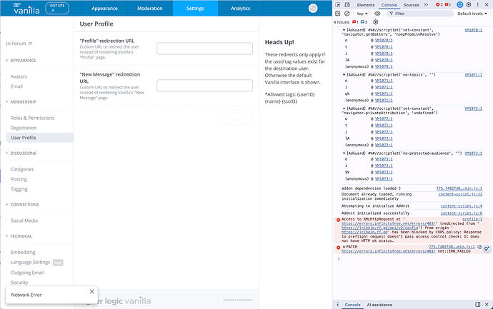

So, I’ve managed to set up a Vanilla Forum site, not using Softaculous but with a custom build. But when I go to edit settings in my administration panel, I keep getting “Network Error”. It also removes the changes I set up.

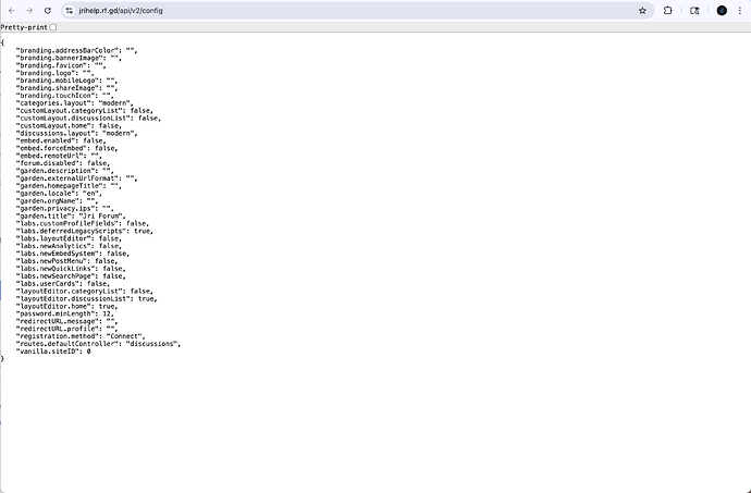

I thought it was a missing file thing, but when I load the file, it exists:

Judging by that second error message, I’m guessing that Vanilla Forums is trying to do a HTTP PATCH request? Those are not supported on our hosting I’m afraid, only the GET and POST methods are supported.
