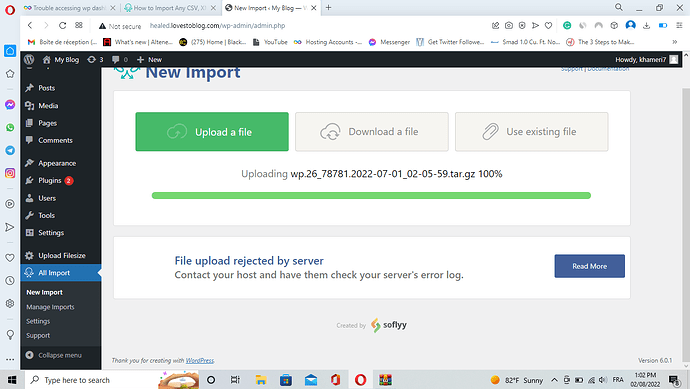

i’ve tried to import the backup file and it says ( File upload rejected by server
Contact your host and have them check your server’s error log.)
