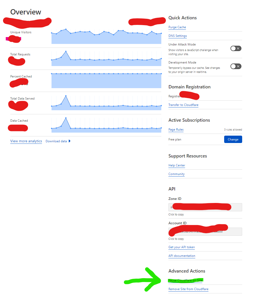

Can you please share your URL, and a screenshot of your Cloudflare DNS settings? No need to whiteout anything.

Weird, because the IP is correct. Try removing the site from cloudflare (Button below green arrow) and add it back again.

I paused Cloudflare on the domain to get it back online.
