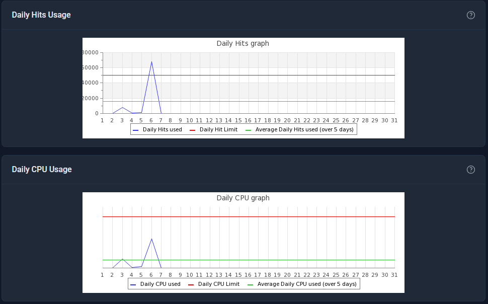

I run a small website which hosts a translation of a webnovel. I barely get any attention and no hits. Suddenly, at 12:15, I get an email from infinityfree saying I used 50% of my hits. One minute later, at 12:16, I got another email informing me I hit the limit and my account is deactivated. Then, I got another email telling me my account was suspended for spam.
The website is down and cloudflare labels it a phishing site, and support informed me that despite the account being listed as blocked for “abuse”, it’s just down because I somehow hit the hits limit.
My only guess on how I got such a sudden spike in hits is I got DDOSsed. Not sure how likely that is. Support informed me that they don’t track such things, so it’s up to me to figure out what happened and hopefully mitigate whatever caused the site to go down.

After checking my site, the statistics plugin said I got 20ish views in total. That doesn’t seem right.

Yup, I read that page already, but nothing in the article really helped me. It’s a very simple website with very few assets, and my average hit usage was very low in the first place. Only one time did it spike up and hit the limit, which I can see on the panel’s statistics page. That’s where my suspicion of a DDOS comes from.

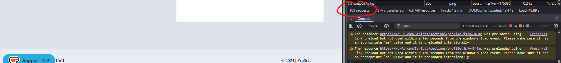

Each page view is roughly equivalent to 110 hits. Is that low?

Still, it feels a bit off. Even if each pageview is 110 or so hits, I get an average of 120ish pageviews, with no more than 200 in total, that’d be around 20k-25k hits at most, right?
Plus
These are not included by your plugin but still counted as hits by the hosting account.

Thanks to KangJL’s image, I have a starting point on how to measure hits, and I know where to start googling to make my website more efficient.
Just to clarify, the statistics on cpanel over the past few months never got close to 50% of the hit usage, nevermind 100%. That’s why when I suddenly hit the limit, I thought it was some sort of attack, not an underlying issue with my site. Using the chrome network analysis tool I found a few things that caused a lot of hits, and disabling/deleting them has reduced my per-page hit count from 130ish to 70. Will keep looking for ways to optimize the site.

That hits usage does not look high enough for a DDoS attack. My guess is you got it by a web scraper or bot (potentially a vulnerability scanner or AI scraper).
You have a free subdomain so not much you can do to avoid this, my recommendations are to get a custom domain and drastically reduced number of hits required per load
