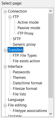

  2. Navigate to “Edit” at the top left of your FileZilla window and click on “Settings”.
  3. Inside the “Select page” section, click the “Transfers” page.

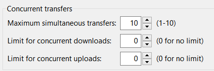

  4. Change “Maximum simultaneous transfers” to a higher number (I recommend at least 5, or if you have a stable internet connection, you can change up to 10). This will increase the maximum file transfers which can be done simultaneously.

I think when you do 10 the server usually blocks it due to 10 clients going onto the ftp at the same time.
What do you think is the safest number?
Ask Admin for that, but I personally use 10 for InfinityFree websites.
I believe 10 concurrent connections works fine here. We don’t set very tight connection limits, we just have a short inactivity timeout to keep the server available.
I usually just start at the maximum and then tone it down according to the server. It helps to keep an eye on the Failed Transfers and the connection log at the top of the screen. If you see error messages there about having too many connections, you can reduce the concurrent connections.
2-4 connections.
