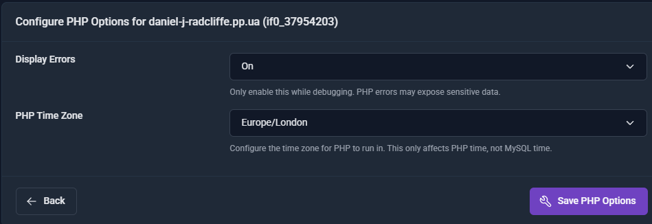

You can change your PHP timezone in the PHP settings:
Our database servers are in the EST timezone. There is no way to configure that for individual users or databases, so that’s something you’ll just have to deal with.
PHP code also runs in the EST timezone by default. However, you can change that through the client area.
