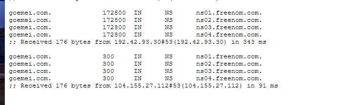

It looks like your NS records changed back to freenoms. You will need to enter your freenom settings page and set them to ns1.epizy.com and ns2.epizy.com

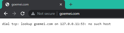

Message from my side
dial tcp: lookup goemei.com on 127.0.0.11:53: no such host

I still see weird results for A and NS
(but for now it may be better to leave it and see what will happen when everything settles down)
And why it works - is probably the reason that you are on this problematic IP 185.27.134.116
which in the meantime began to work.
