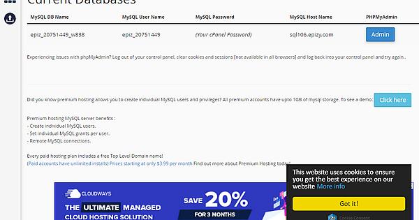

The website works, but the database cannot be accessed through phpMyAdmin. The cookies are cleared. https://imgur.com/a/PBJfQio
Softaculous has a bit of a weird way of setting up databases. It creates separate database credentials, which work most of the time but also have seemed to break spontaneously.
The phpMyAdmin issue is interesting. I’ve seen other people report the same issues, but I have not been able to figure out why it doesn’t work. Judging by what has been said in this topic, I suspect that the Softaculous integration may have to do with it. I’ll make a note to dig into the issue some time this week.
