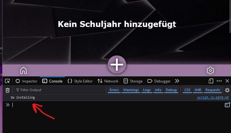

I‘m currently developing a WebApp and in the latest version I tried adding a service worker to handle server request, so I‘d use less hits for a page load once the service worker is installed. Everything works fine on localhost, however on InfinityFree, I get the above error from my error handling.

  5. Make sure the Service Worker file itself is being served with the correct MIME type (application/javascript).

as far as I can see, favicon.ico does not exist on the beta location
