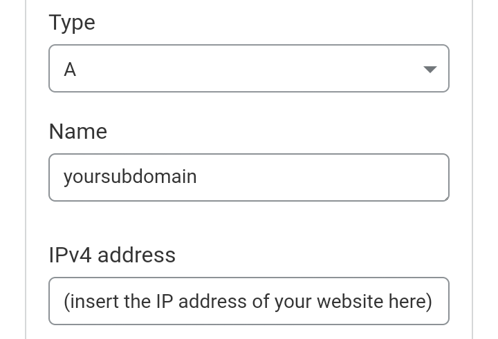

If you’re using Cloudflare to manage your DNS externally then first create a subdomain in the Control Panel, next go to Cloudflare’s DNS editor and then create an A record like this:
To find the I.P. address of your site, just check your other existing A records like the A record of your root domain which should have the same I.P. with your subdomain.

No he doesn’t. He needs 2 temporary NS records with his subdomain name pointing to ns1.epizy.com and ns2.epizy.com. Then he creates an account. Once completed, he will then see his server ip address in the client area. He copies it and deletes the NS records and creates an A record with the sub domain name and pastes the ip on the value box.
