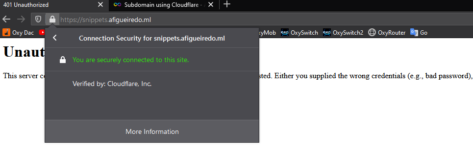

I didn’t enable Cloudflare in Infinityfree CPanel. My domain DNS management is hosted by Cloudflare.

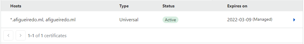

The SSL certificate issued by Cloudflare is valid for the domain and all first level subdomains as you can see here:

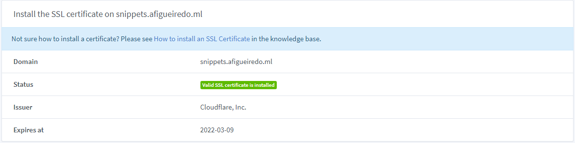

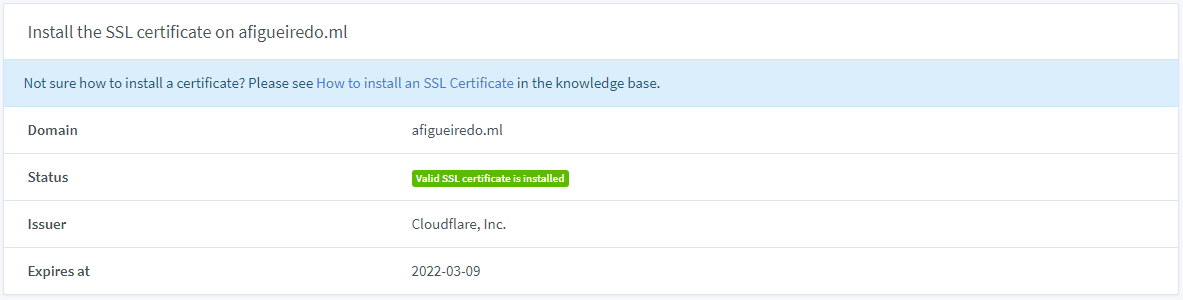

These certificates both exist in Infinityfree’s “Free SSL Certificate” panel. You can check that here:
And here:

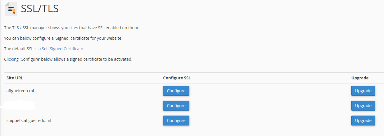

No, you did not. Pls show TLS/SSL section for subdomain in Vpanel. The SSL cert for subdomain need to be installed in VPanel in order to use full mode.
I don’t know if the post will be flagged again but here it goes:
I am only interested with the screenshot from VPanel. What you are showing is not helpful at all.

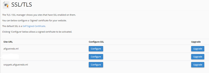

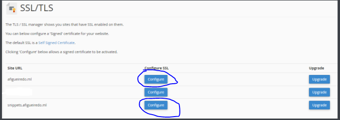

You mean here?
I didn’t create a certificate here for the subdomain, but I didn’t do it for the main domain also and it’s working.
Besides, I tried to create one here and it throwed an error. When I searched for that error in Infinityfree’s knowledge base, it mentioned something about not accepting keys generated by Cloudflare.
Full mode will require SSL certs to be installed.
Use the InfinityFree SSL tool. Keys generated by Cloudflare will not work.
