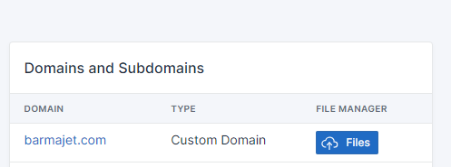

subdomain didn’t appear in infinityfree client area yet

And as for your second question, did you reate the subdomain in the control panel? It should be created in the control panel as well as in cloudflare.
