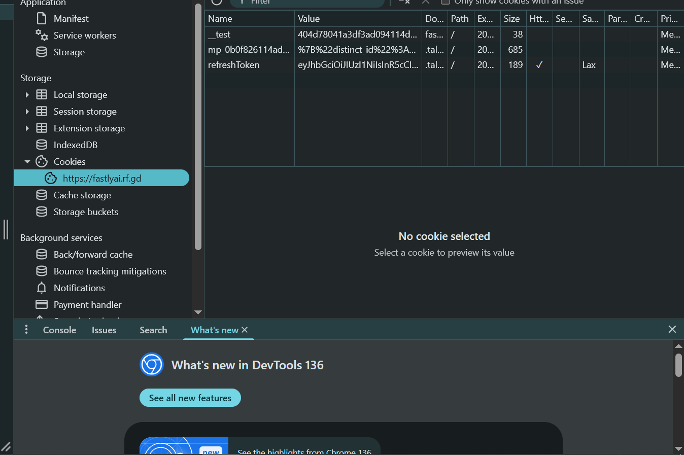

If I refresh the website the same thing keeps happening, the _test cookie is in my browser so I don’t understand why it’s not working, I don’t know why the 500 error it returns is actually because sometimes it doesn’t give it to me, generally it returns the AES script, I leave images for evidence

Note that you don’t just need to have a test cookie, you need to have a valid test cookie. While the cookie expiration is set to a very long time, the actual server parameters get rotated quite frequently, which can cause issues with AJAX requests on pages that are open for a long time.

the problem with the aes script was solved by itself, just as it appeared it disappeared, maybe it had something to do with the cookies since I deleted them and the cache a lot of times as @Greenreader mentioned, I no longer have any problems with the AES script, but just to clear up any doubts 100%, infinityfree does not limit calls to external APIs? like Google, openai, etc. to name a few, since the documentation https://forum.infinityfree.com/t/ensuring-only-web-browsers-can-access-your-website/49353 they have is not so clear, about what they are referring to when they say:
