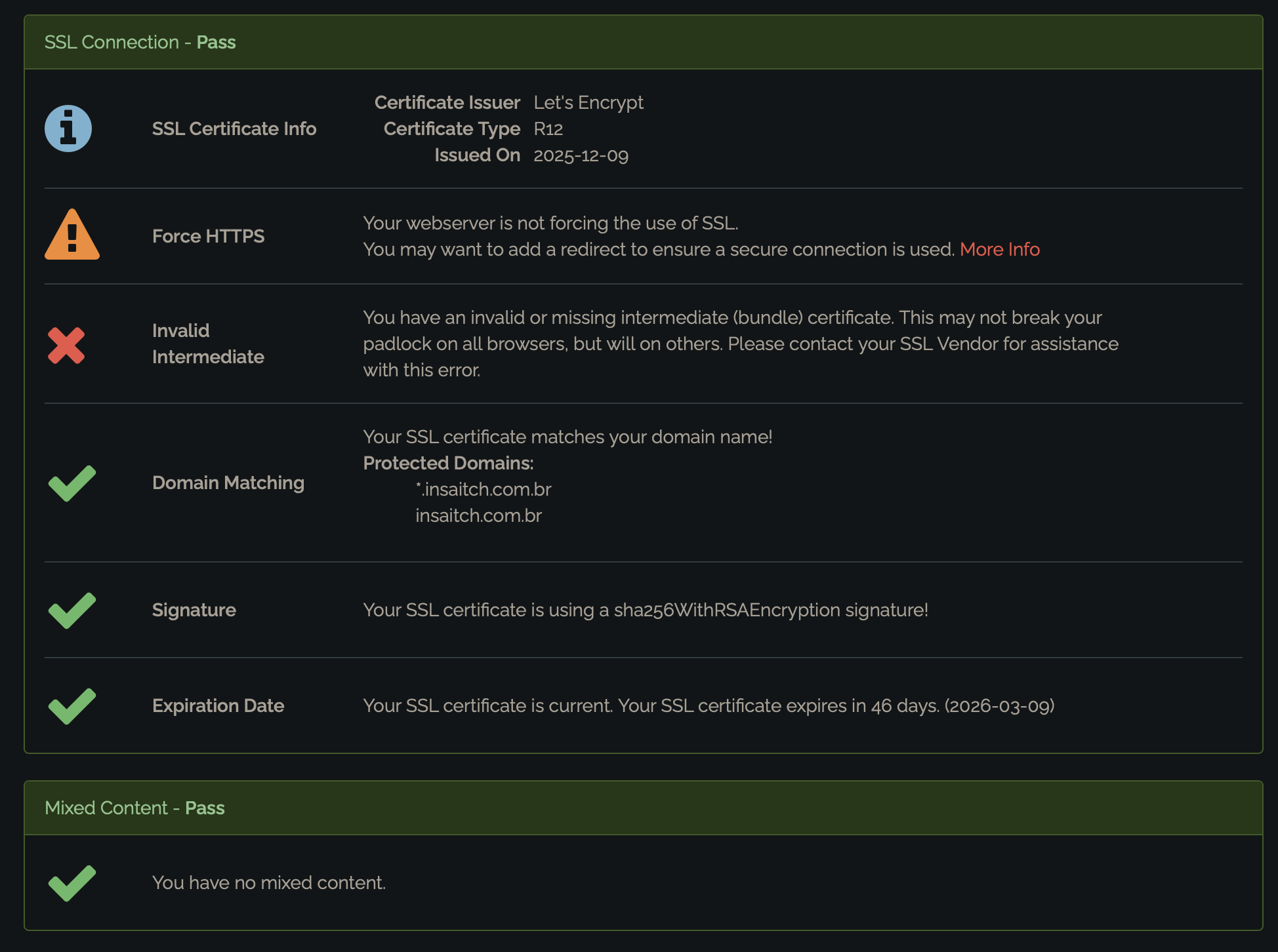

I apologize, I didn’t intend to do anything “wrong,” I was sincerely seeking help for the same problem that was being discussed in the open forum.

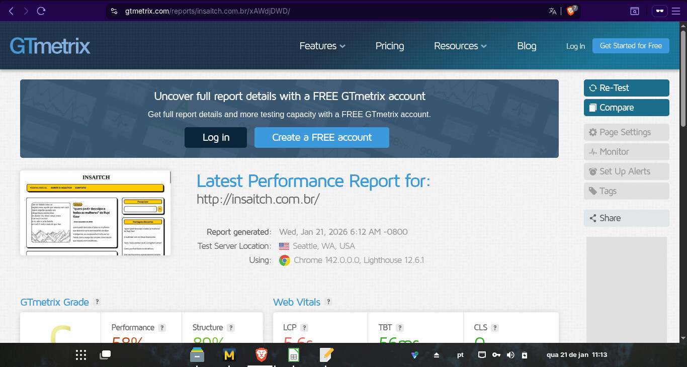

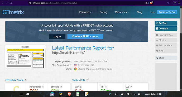

The site cache is cleared regularly. The problem is noticeable on verification sites like: https://www.whynopadlock.com/; https://gtmetrix.com/; and occurs even in incognito tabs.
Here are some screenshots (I could only attach one - I added an incognito window test).

The problem occurs even in incognito tabs; I tested it. So, it’s not just a full cache in my default browser. The problem is explained on verification websites such as: https://www.whynopadlock.com/; https://gtmetrix.com/
And the website’s own cache is regularly cleared with the WP Rocket plugin.

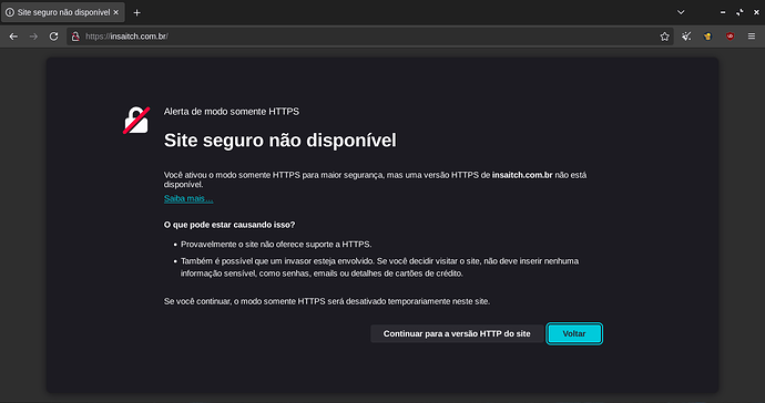

I don’t think it’s my browser’s cache. Some browsers—yours, the moderator’s, and a few of mine—work fine, but not all of them, and that’s the problem because HTTPS isn’t functional and isn’t being forced for everyone.
If you have any other instructions, I would appreciate it and am open to possible new solutions.

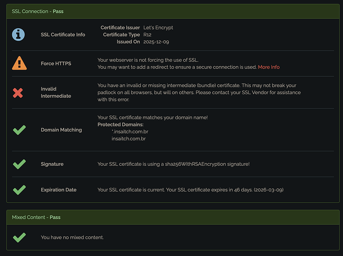

Verification sites like those usually fail all websites on free hosting because they are looking for a type of certificate that free hosting does not support. You can’t use those sites to reliably test if a website is secure.

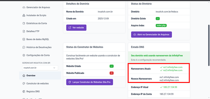

But right now you don’t have any nameservers on your domain, so your website is not working at all. You should fix that first with your domain registrar.
Thank you for this information and clarification regarding these sites, Green.
However, apparently I have the name servers configured correctly on InfinityFree with the domain registrar. Apparently, at least. Here is a screenshot of the configuration screen.
I will continue investigating.
Or, when you say name server in my domain does it mean something different from this?

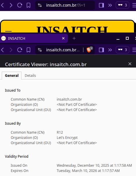

Your SSL loads successfully on my side as well.

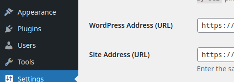

Additionally, make sure your Wordpress and Site Addresses both use “https” in Settings → General.

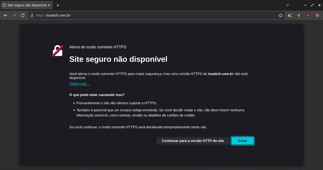

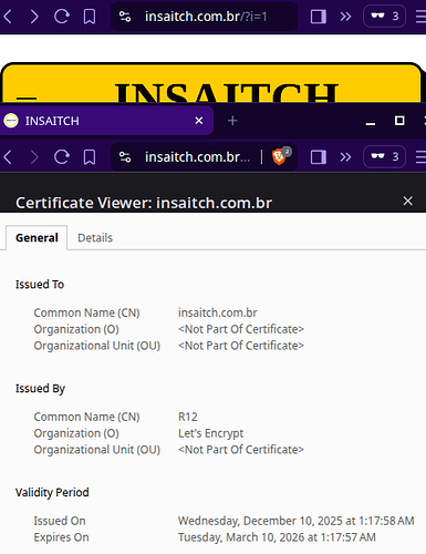

I see that you are using Mullvad browser which is a highly secure browser. I just tested in Tor browser (For context Mullvad is just Tor browser without Tor) and it fails as well.
This is because these specific browsers actually look for intermediate certificates which free hosting doesn’t support.
So unfortunately there’s no way to get this issue sorted out for these browsers. It won’t work, unless you are willing to upgrade to premium hosting.
For everyone’s interest, the results from whynopadlock is accurate. It is a Pass and it do break on some browsers.

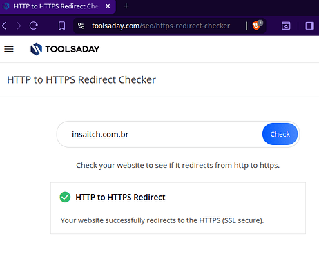

The not forcing HTTPS in whynopadlock is informational and least of your worries. The htaccess instructions posted earlier from IF and Host2B return status 301 and the More Info from whynopadlock return 302. Pretty sure the browser redirects but why did whynopadlock report otherwise? I have no explanation but maybe the server receiving the request is different from the server processing it? Maybe whynopadlock cannot go beyond that initial step.
I used other ssl checkers online but whynopadlock only was “No Force HTTPS”. If you use a different one, you’ll get a different result:
