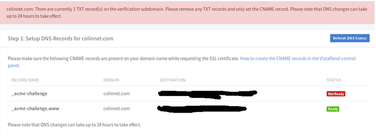

Did you already pointed your (http:// colinnet dot com) domain into infinifyfree namservers and you have already put it into the addon domain?
I just did this, thanks!
Remove the cheerymood.rf.gd addon domain, because the ssl wont work on it and try connecting the ssl again to your .com domain.
Did this now too, thanks! …but… my domain is now SSL certified (to the naked eye) but there’s some issues I don’t know how to solve on the SSL page :(:

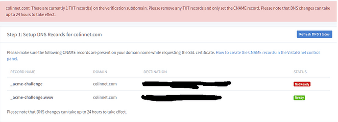

[pic’s error message read at the top:
colinnetdotcom: There are currently 1 TXT record(s) on the verification subdomain. Please remove any TXT records and only set the CNAME record. Please note that DNS changes can take up to 24 hours to take effect.
Final Edit Continued: And the status on the acme-challenge was red and in Not Ready… Perhaps because the weird and wrong way I initially had my sites set up or whatever, but I think w/ your guys’ help, I actually kinda installled the SSL a little backwards but I -think- it might work? [edit: it does work…finally!]
I think I figured out maybe what to do? (Final Edit Continued: it does work!)- the final step I had to do to get it working was I went to cpanel’s cname’s and added the 2 acme record names to my [newly added] colinnet domain - i refreshed and it was still saying the same error, but also that DNS effects could take 24 hours to take place - so a few hours later now i’ve checked and everything’s literally Green now! so once again -thank you- katufo and everyone else so much [DigibytechsOrg, and UnknownLolz) who replied and offered the (actual numerous) solutions! Hope this helps out somebody in the future!
