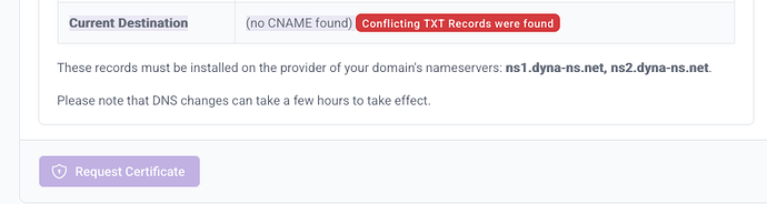

Hi,
Would someone know how to fill the CNAME data on Dynadot, as am not familiar with it ?
And just while asking for a SSL certificate, the infamous red message about conflicting TXT records were found, just showed up, even before tryng to access to Dynadot.
Thanks

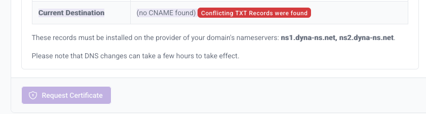

Hi, am just facing the same issue, with this error
Current Destination (no CNAME found) Conflicting TXT were found.
Would somebody know what to do to sort this out ?
On Dynadot DNS settings it seems not very handy to fit all those lines.
But the error appeared way before i accessed to the DNS.
Thanks

Please go to your dynadot DNS panel to see if there’re already a TXT record for _acme-challenge.mobilchips.com.

From what I remembered, DynaDot uses Cloudflare for its DNS, so it’s possible that the same mechanism that caused this issue on Cloudflare domains also applied to you.
Please give it serveral hours and see if it helps.
I checked it, and this is just a bug in the client area. DynaDot’s nameservers are not the same as Cloudflare’s, but they respond differently than any nameservers I’ve seen before, causing the client area to behave unexpectedly. That’s being fixed now.
That said, the CNAME record you need to configure is really missing. The bug in the client area doesn’t prevent you from getting an SSL certificate, but not setting up the required DNS records will.
