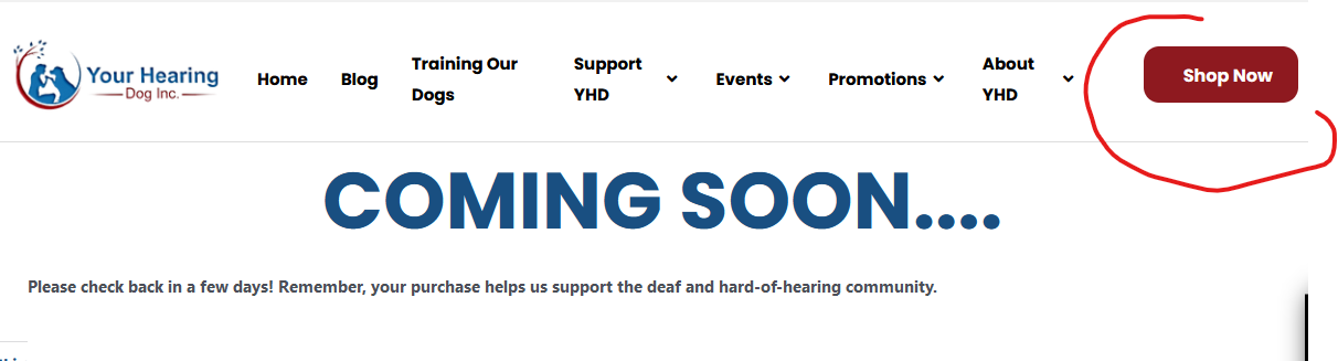

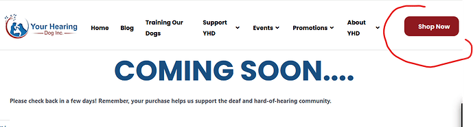

But okay since I see that you intend to sell something on the site
then full strict mode has more advantages especially when integrating some third-party payment services, etc. into your website.
