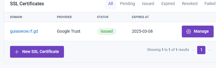

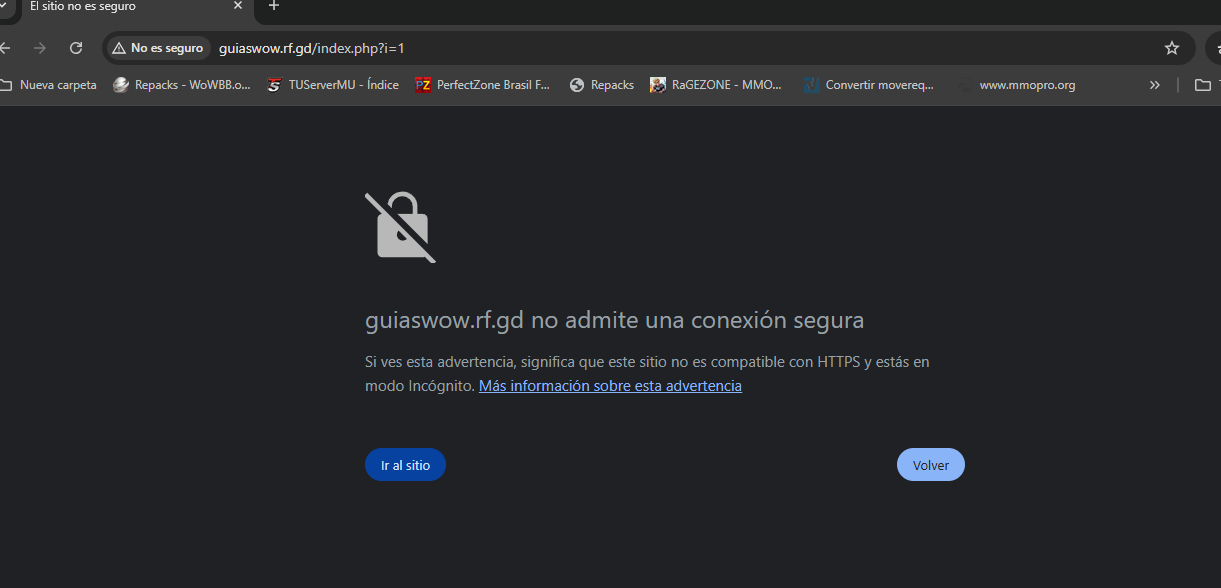

I get that it does not support a secure connection. My SSL is already active. My forum continues like this.

I see this instead

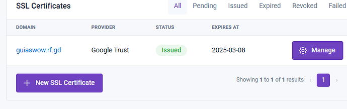

This is the reason for your SSL problem:
You have obtained a Google Trust SSL certificate, but it’s not installed yet. Simply click the Install button to fix that.
