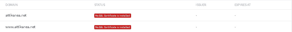

And what permission should i apply for this ?
I edit directly the .htacces file and now i can not access my domain
I checked your domain name and no SSL certificate has been uploaded to it. Please note that you need to upload both the private key and the certificate to your control panel. One can’t work without the other.

Sorry guys for the confusion.The certificate is installed correctly now.I don’t know what has happened.
