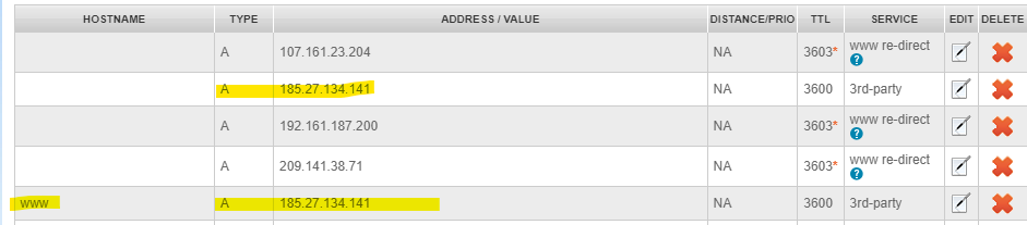

Can you please screenshot the setting(s) that are currently pointing your domain to InfinityFree?
I initially set my nameserver to ns*.epizy.com, but changed the nameservers back to namesilo’s default name servers after a couple of days. The domain name is still pointing to my website hosted on infinityfree.
Here’s the screenshot with the A records.

What are the other A records for? The hostnames are the same, so I think that’s going to cause some errors. I would remove all A records except for the IF ones

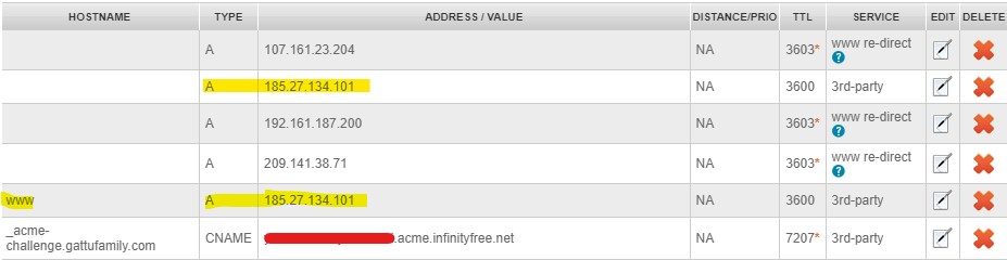

Also, can you screenshot the DNS CNAME records for the SSL certificate?

I set the A records to the IP address from app.infinifree.net. The other A records are included with Namesilo - I don’t know their purpose but I don’t think they are interfering with the SSL cert.
I included the screenshot of the CNAME for the SSL cert, but blacked out the code.

When I do a DNS lookup by hand, I don’t get any results for the CNAME record. And here is an example of that query using a web based DNS lookup tool:
Looking at the screenshot of the DNS settings at NameSilo, it looks like you provided the right configuration, but somehow this isn’t being applied on NameSilo’s nameservers.
Perhaps you could try asking NameSilo about this? Because the problem seems to be in the nameservers, not our DNS check.
Upon advice from Namesilo support, I deleted the CNAME record and recreated it. I will check after 48 hours of propagation if the issue is resolved or not.

I just checked again and it seems OK now. So you can probably get the certificate now.
It takes up to 48-72 hours for DNS propagation, but mostly due to stupid DNS caching. Both our CNAME validator and the certificate providers are configured to pick up DNS changes within minutes.
