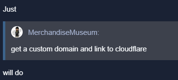

Just
will do
what do you mean “Just will do”
Read
you mean i cant use my subdomain for cloudflare?
i just want to have a clear answer if there is another way to link my woocommerce to google merchant, and do my issue even affect the idea of that or is it a critical thing to do that if i didnt google wont accept my apply for google merchant center?
The SSL implementation on free hosting is limited, which may cause issues with automated checks. It’s likely that the Google Merchant Center issue you’re having is also the result of this.
Cloudflare works because it transfers the SSL implementation to Cloudflare, and away from our hosting. But Cloudflare doesn’t allow free subdomains to be moved to their service, and we don’t provide the means to do so, so you must get your own domain name to use Cloudflare.
Premium hosting has a different, more complete SSL setup, so it doesn’t have this issue.
But the end result is that there is just no way to work around this SSL limitation without spending money: either you need to buy hosting, or buy a domain name.
