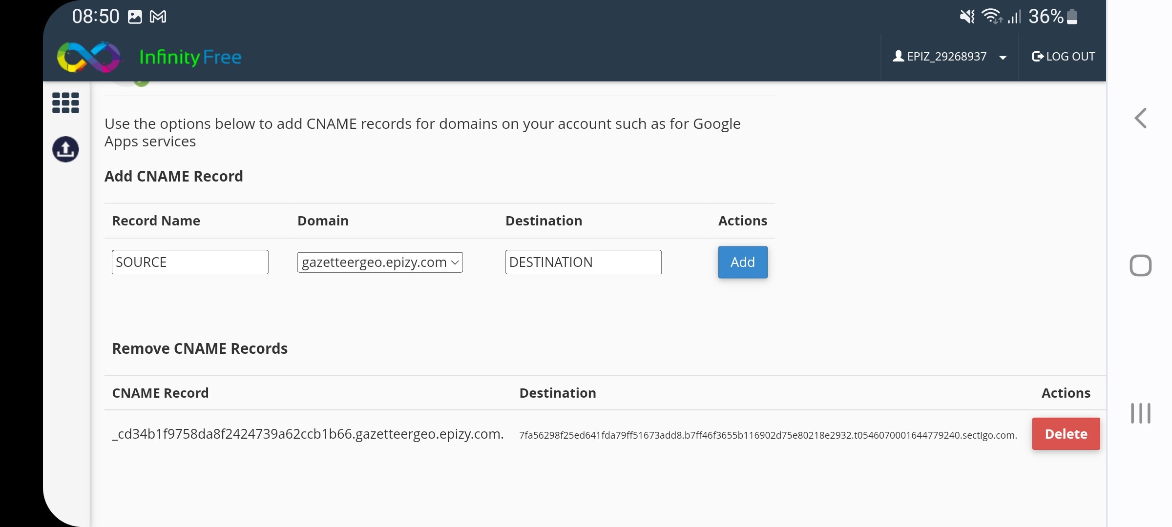

I did. SSL is still pending. it should take hours to activate it not 8 days. Could you please sort this out?
Which provider are your using for SSL?
Gogetssl
Did you set up the CNAME records?
So you are trying to use GoGetSSL?
Also note that DNS changes can take up to 72 hours to reflect across the world.
Yes. But I’m waiting on thus since 2nd of june!
Can you also screenshot the SSL page in the client area?
Thanks
Click on the SSL certificate that you are trying to install and screenshot again.
Look at the record that it is asking you to add, and look at the record in the control panel. They are not the same.
You need to create the record that the control panel is intructing you to.
